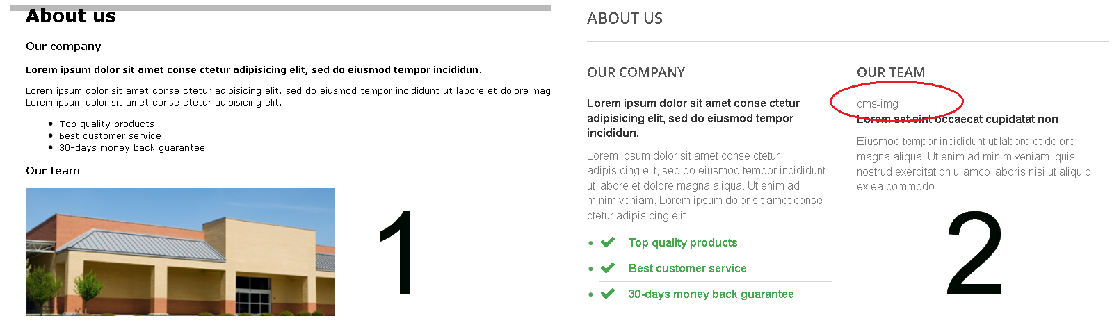

al nahian Posted July 31, 2014 Share Posted July 31, 2014 Hello, I am using "prestashop_1.6.0.8" (localhost). I found that the "About us" page is not showing "cms-img.jpg" image. I can add the image in my back office (preferences -> CMS -> About us). The source of the page includes "<img title="cms-img" src="../img/cms/cms-img.jpg" alt="cms-img" width="370" height="192" />". In the "Edit: About us" page, the image is shown prefectly. But whenever I visit About us page, I find that the image below "OUR TEAM" header is not available. I found several discussions about this problem but none of them worked for me. The .htaccess file img/cms folder contains the following code: <IfModule mod_php5.c> php_flag engine off</IfModule>deny from all<Files ~ "(?i)^.*\.(jpg|jpeg|gif|png)$"> order deny,allow allow from all</Files> Please help me regarding this issue. Link to comment Share on other sites More sharing options...
vekia Posted July 31, 2014 Share Posted July 31, 2014 you've got problem with image only in back office or both in front and back end? Link to comment Share on other sites More sharing options...
al nahian Posted July 31, 2014 Author Share Posted July 31, 2014 Hi vekia, the back office is showing the image. But the front end is not. I attached the screenshot of back office and frond end with this reply. No 1 is back office and No 2 is front end. Please check the image. Thanks. Link to comment Share on other sites More sharing options...
al nahian Posted July 31, 2014 Author Share Posted July 31, 2014 Update: I just installed another shop from scratch (prestashop version 1.6.0.8). But I am facing the same problem with this fresh installed shop. I can see the image in back office but the front end is not showing the image. How do I solve this problem ? Link to comment Share on other sites More sharing options...
al nahian Posted July 31, 2014 Author Share Posted July 31, 2014 Okay, I think I found the solution. In the back office, the About us page contains the image "cms-img". But the image is not shown at front end. The image link provided by default was "../img/cms/cms-img.jpg". The link should be edited like "localhost/your_project_name/img/cms/cms-img.jpg". Now the image is shown properly. Link to comment Share on other sites More sharing options...
