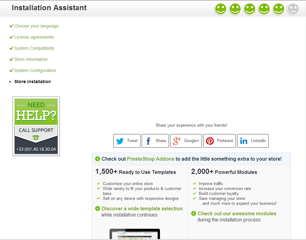

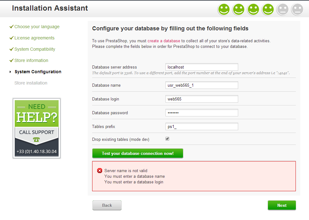

Goochy Posted July 29, 2014 Author Share Posted July 29, 2014 Okay, I've turned error reporting on and at first it gave me the errors shown in the screenshot (002) After that, I entered my correct database information. But again pressing the check button does nothing and the "Next" button brings me to this blank page again (Screenshot 003). Thanks for trying to help me Link to comment Share on other sites More sharing options...
