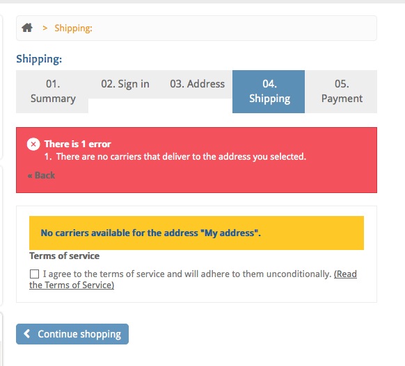

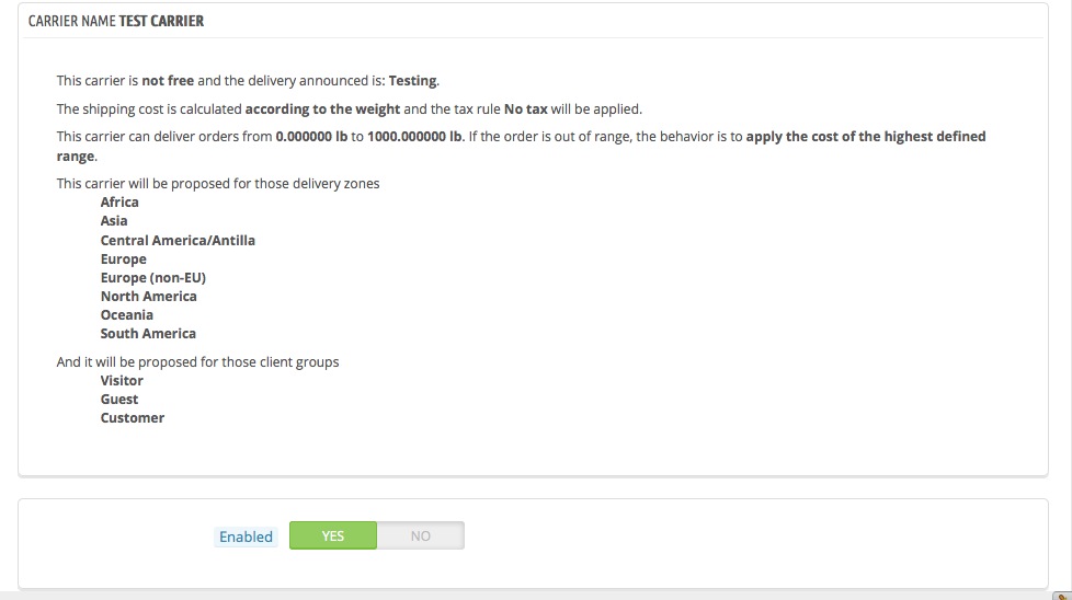

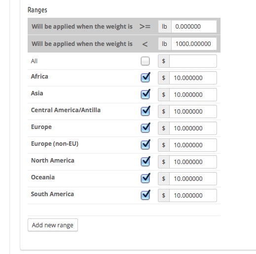

bgood3354 Posted July 21, 2014 Share Posted July 21, 2014 I am using PS 1.6.0.8. I have not been able to get carriers assigned to domestic (USA) orders even though I installed USPS and UPS modules so tried this test. 1. Turned on all Zones. 2. Turned on several different countries. 3. Confirmed that US has States turned on. 4. Confirmed that the states involved in my test are Enabled. 5. Disabled all current carriers and created a new custom "Test Carrier" and set parameters so that "Test Carrier" could ship any box under 1000 pounds to anywhere in the world for $10. See attached screen grabs. 6. I changed the Default Carrier to "Test Carrier" 7. Created a new test user with an address in the same state as my store and place an item (shipping weight = 1 pound) into shopping cart and proceeded to checkout. As you can see from the attached I still get a "No Carrier" message. Is there any way to fix this short of deleting my entire store and starting over? Thanks, Bob Link to comment Share on other sites More sharing options...
