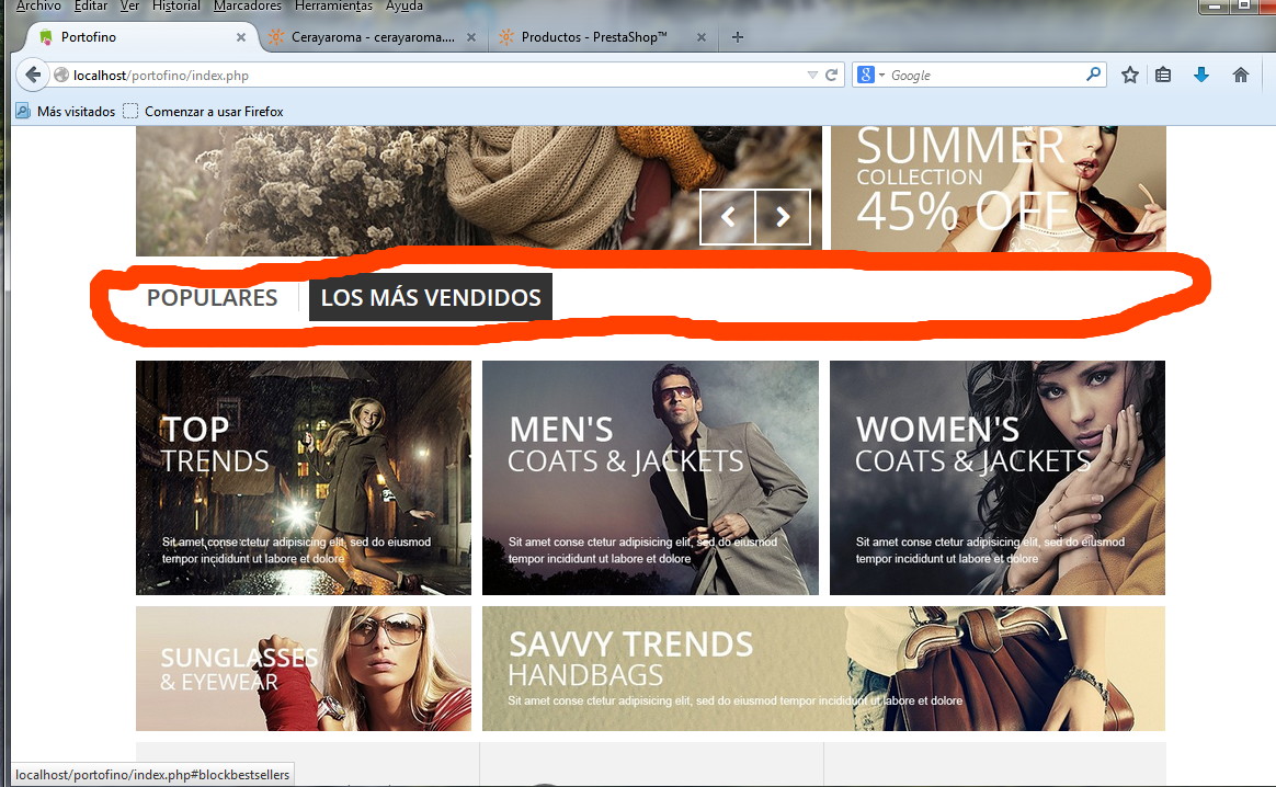

newtronics Posted July 10, 2014 Author Share Posted July 10, 2014 (edited) ¡Solucionado! Muchas gracias, Lastapril. Edited July 10, 2014 by newtronics (see edit history) Link to comment Share on other sites More sharing options...

lastapril Posted September 2, 2014 Share Posted September 2, 2014 Los productos destacados se muestra en el home con el modulo homefeatured, fijate que lo tengas en el hook DisplayHome Link to comment Share on other sites More sharing options...
