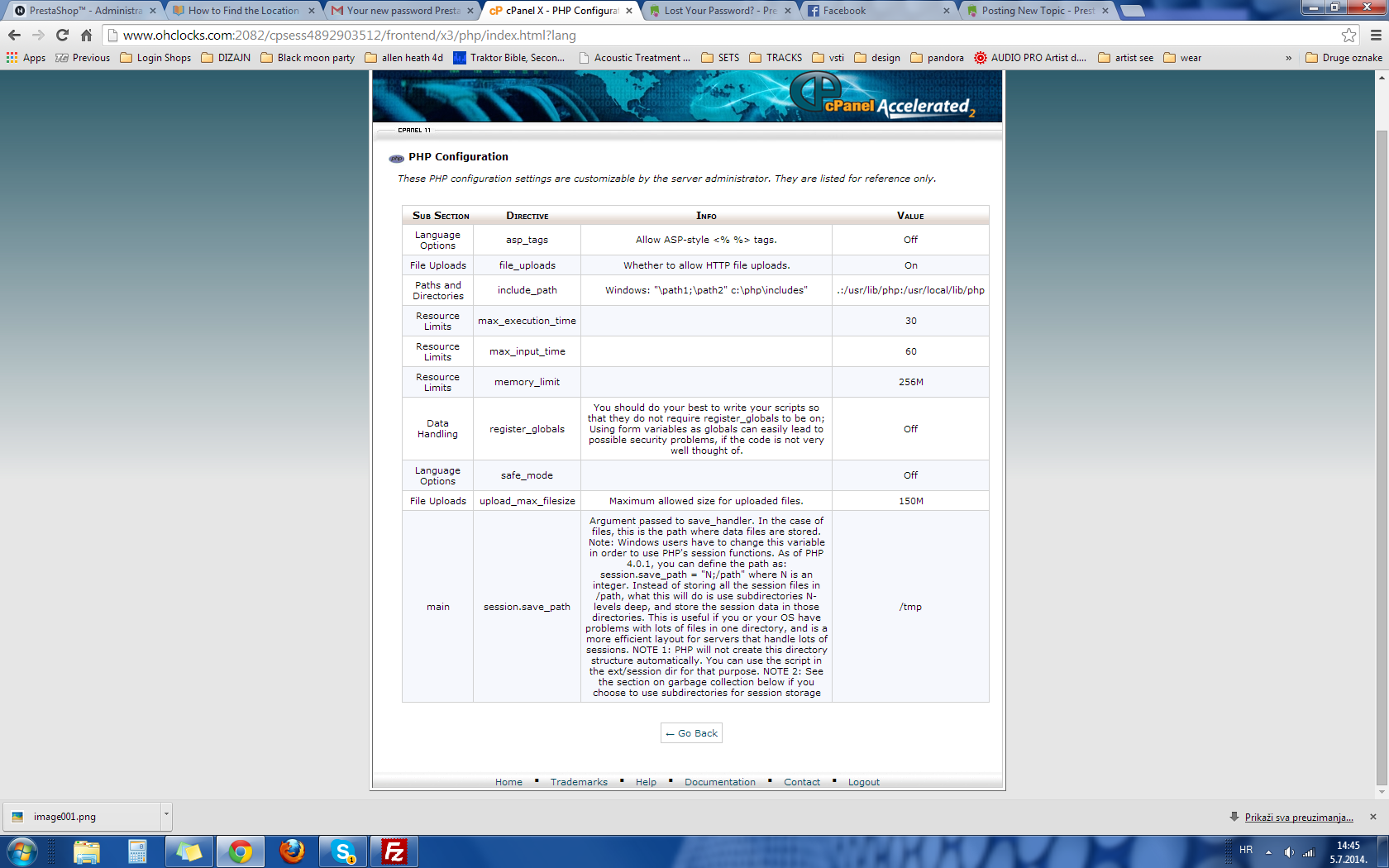

nightsquad Posted July 5, 2014 Share Posted July 5, 2014 Can't make simple change in preferences. It says : The chosen limit is superior to the server's maximum upload capacity. You need to increase your server limit. On server upload limit is set to 150 mb, what else can i do. I went through forum history but without solution. Link to comment Share on other sites More sharing options...

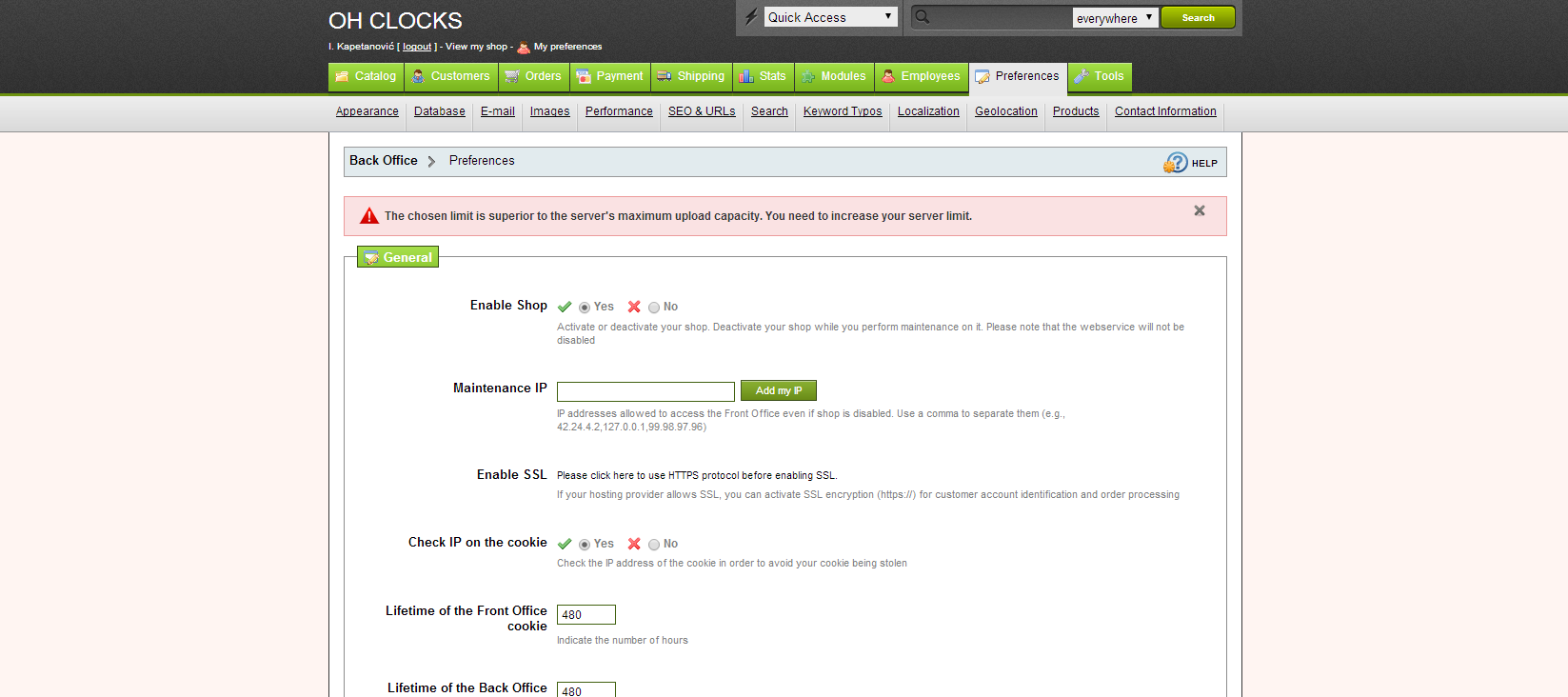

nightsquad Posted July 5, 2014 Author Share Posted July 5, 2014 Can't make any changes in preferences. If i wan't for example disable shop, it says The chosen limit is superior to the server's maximum upload capacity. You need to increase your server limit. Administrator is telling me that it's internal config Don't know if it's true, or where else to modify it.. Link to comment Share on other sites More sharing options...

vekia Posted July 6, 2014 Share Posted July 6, 2014 check also post_max_size param, its connected to upload files too Link to comment Share on other sites More sharing options...
nightsquad Posted July 6, 2014 Author Share Posted July 6, 2014 (edited) In "Back Office Preferences > General" i got this message.. How to change that post_max_size param,, which file to edit? Thanks Prestashop Version: 1.4.11.0 Edited July 6, 2014 by nightsquad (see edit history) Link to comment Share on other sites More sharing options...
PSfever.com Posted July 6, 2014 Share Posted July 6, 2014 In "Back Office Preferences > General" i got this message.. How to change that post_max_size param,, which file to edit? Thanks Prestashop Version: 1.4.11.0 You would have to edit the php.ini file to change the post_max_size parameter. Link to comment Share on other sites More sharing options...
nightsquad Posted July 6, 2014 Author Share Posted July 6, 2014 Finaly done! I was editing php.ini in public html, and now found other php.ini in admin folder which was crucial. Thanks Link to comment Share on other sites More sharing options...
