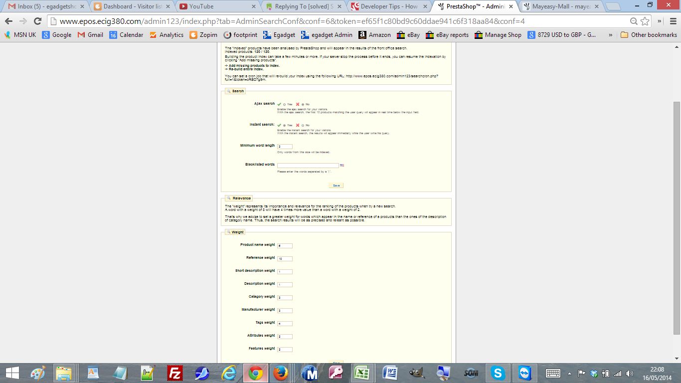

[email protected]. Posted May 16, 2014 Share Posted May 16, 2014 Can anyone from prestashop help please, I am currently running 1.4.4.1, the search function was never worked at all from the first place when I bought it. I have tried all methods stated here, but none of them work, my site is http://www.epos.ecig380.com/ And my back office settings are as follows... https://www.dropbox.com/s/i9140cgr4y4gfcl/Screenshot%202014-05-16%2022.08.15.png Please advise what have I done wrong...? Link to comment Share on other sites More sharing options...
