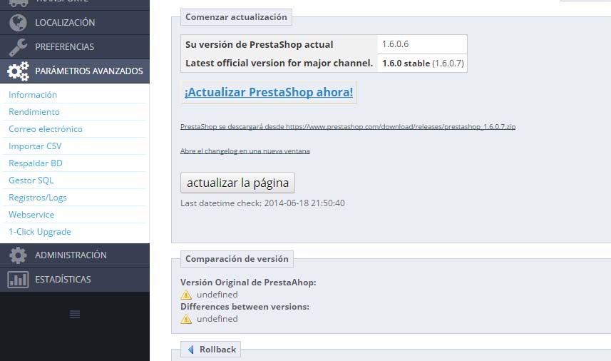

straits Posted June 19, 2014 Share Posted June 19, 2014 1click upgrade show me that. PrestaShop Original version: undefined differences between versions: undefined the upgrade dont work any help? tanks Link to comment Share on other sites More sharing options...

innovacy Posted March 15, 2015 Share Posted March 15, 2015 (edited) The issues is with the autoupgrade module. If you are using a socket to connect to your database, so something like: define('_DB_SERVER_', 'localhost:/var/run/mysqld/mysqld.sock'); or like: define('_DB_SERVER_', '/var/run/mysqld/mysqld.sock'); within your settings.inc.php file, then the autoupgrade will just simple fail. Change it to a host:port combination like this: define('_DB_SERVER_', 'localhost:3306'); and it should be working then. Edited March 15, 2015 by innovacy (see edit history) 1 Link to comment Share on other sites More sharing options...
PeterVajda Posted March 19, 2015 Share Posted March 19, 2015 I definitely owe you a beer. This was the problem that no one was able to solve. Thank you The issues is with the autoupgrade module. If you are using a socket to connect to your database, so something like: define('_DB_SERVER_', 'localhost:/var/run/mysqld/mysqld.sock'); or like: define('_DB_SERVER_', '/var/run/mysqld/mysqld.sock'); within your settings.inc.php file, then the autoupgrade will just simple fail. Change it to a host:port combination like this: define('_DB_SERVER_', 'localhost:3306'); and it should be working then. Link to comment Share on other sites More sharing options...
