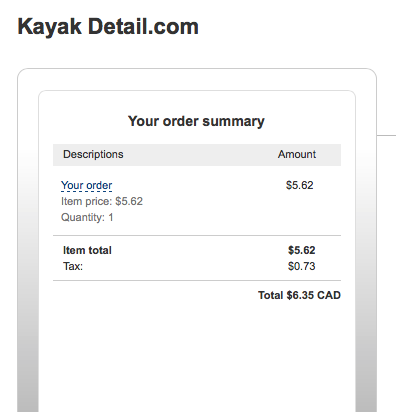

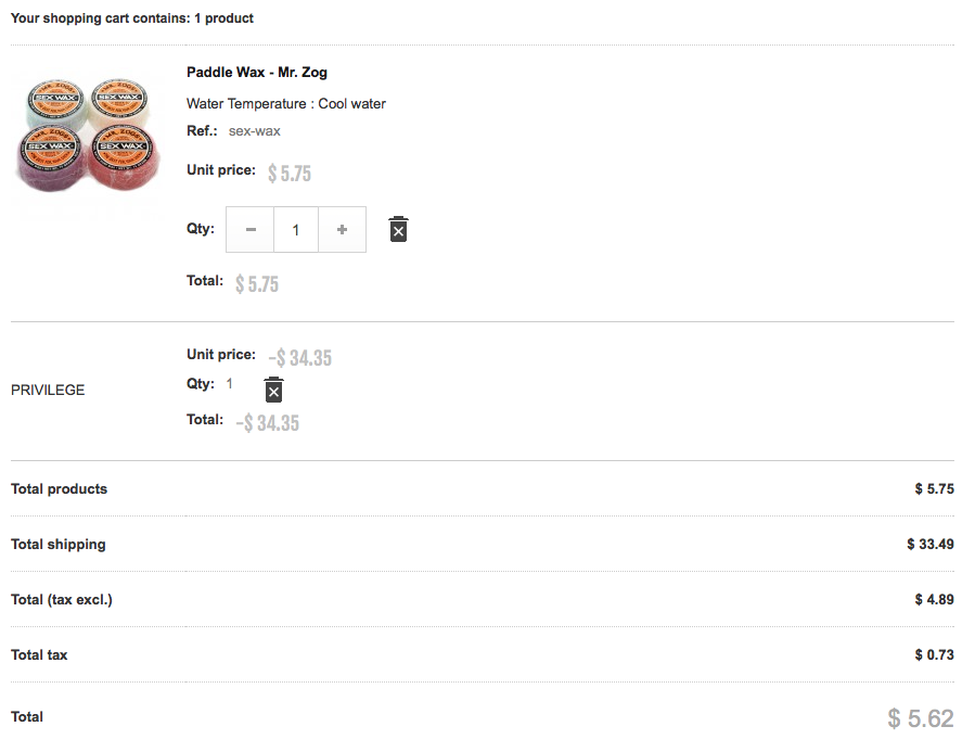

Flakkak Posted June 19, 2014 Share Posted June 19, 2014 (edited) Hi everyone, As my shop is almost ready to open, I am facing this problem when offering a discount to customers. The checkout cart is all good, but when the customer goes to the Paypal Checkout page to process to the payment, Paypal adds the taxes again. This only occurs when offering a promo-code. When there is no discount, everything is fine and Paypal doesn't charge the tax twice. Prestashop 1.5.4.1 Paypal Usa, Canada v.1.3.4 You can see the screenshots to understand what the problem is or try it yourself on my website with the promo code: www.kayakdetail.com promo code: kdouverture I searched on forum to find a solution to this, but all I found was some code manipulations to problems when Paypal was always doubling taxes, which is not the case here. Thanks a lot for your help !! Edited July 22, 2014 by Flakkak (see edit history) Link to comment Share on other sites More sharing options...

Flakkak Posted June 19, 2014 Author Share Posted June 19, 2014 Yes I have. It solves the Vouchers problem. But with this fix, when there is no CartRule / Vouchers, there is no tax applied on a 'normal' order. Link to comment Share on other sites More sharing options...
Flakkak Posted June 19, 2014 Author Share Posted June 19, 2014 Sorry it wasn't really clear. But no, it doesn't fix the problem as it brings another one. --> No tax at all. Help would be much appreciated. Link to comment Share on other sites More sharing options...
