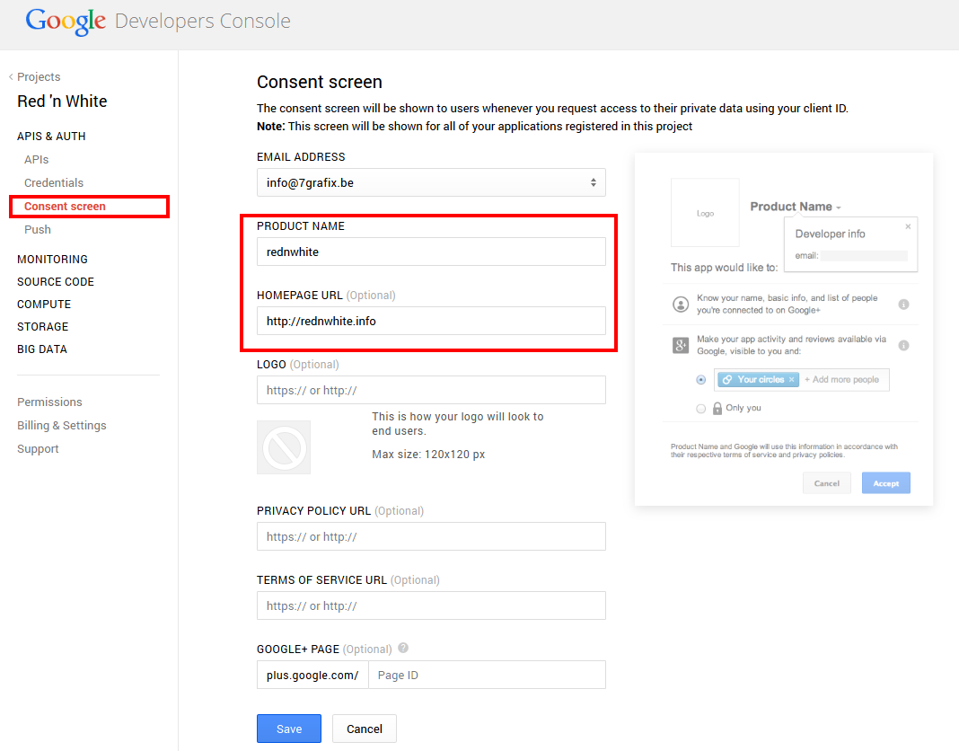

Code Agency Posted June 29, 2014 Share Posted June 29, 2014 You need to add a name to your API project, after that problem solved 1 Link to comment Share on other sites More sharing options...
asdevelopment Posted August 6, 2014 Share Posted August 6, 2014 Hello, I've added a name for the project but the 400 issue still there, any idea? thank you for your help Link to comment Share on other sites More sharing options...
Code Agency Posted August 23, 2014 Share Posted August 23, 2014 You have fill in correctly your URI? domaine.com/modules/gapi/oauth2callback.php did not match a registered redirect URI You need put your url to your prestashop here Hello, I've added a name for the project but the 400 issue still there, any idea? thank you for your help Link to comment Share on other sites More sharing options...
Manu_manu Posted December 14, 2014 Share Posted December 14, 2014 Merci beaucoup pour avoir mis le doigt sur le manque d'attention lors de l'installation de l'api. google pré-remplis le champ URI du coup ont valide sans vérifier, et il s’avère que le chemin n'est pas bon d'ou le 400. Il faut bien rentrer le chemin indiqué : votre domaine/modules/gapi/oauth2callback.php . Merci [email protected] Link to comment Share on other sites More sharing options...
