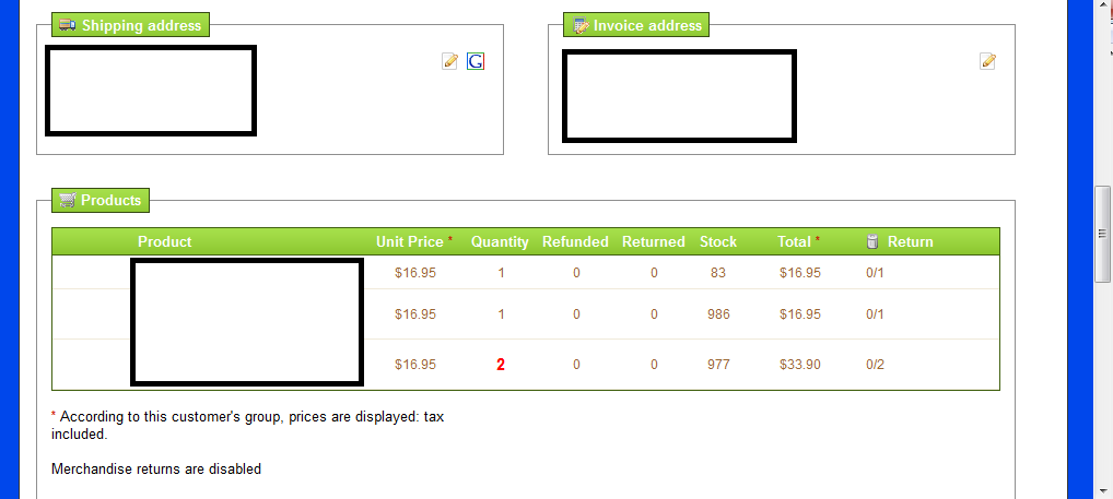

Since the bank transfer order, all order pages are not displaying all the necessary information. The page is cutting off after the area where it displays "Shipping Address" and "Invoice address".
The parts missing that used to be there are
- Products
- New Message
- Merchandise Returns
- Messages
- Credit Slip
This is now missing for all orders.

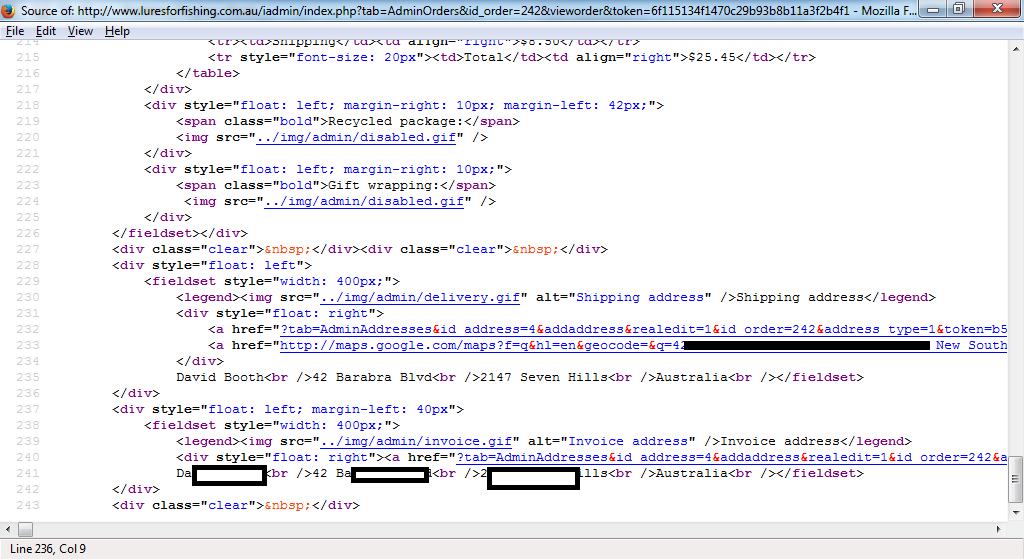

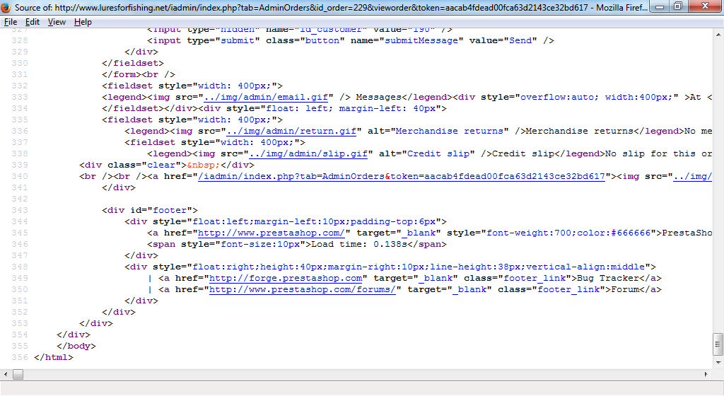

I suspect its something to do with the page as when I "view Source" on an old test site the last line of code on the problem site is "<div class="clear">&nbsp;</div>"
The working site shows </html> as the last line.
There is around 100 lines of code missing on the problem site. The prestashop footer also isnt appearing. This is the only page this happens on. The rest of the site is fine.
