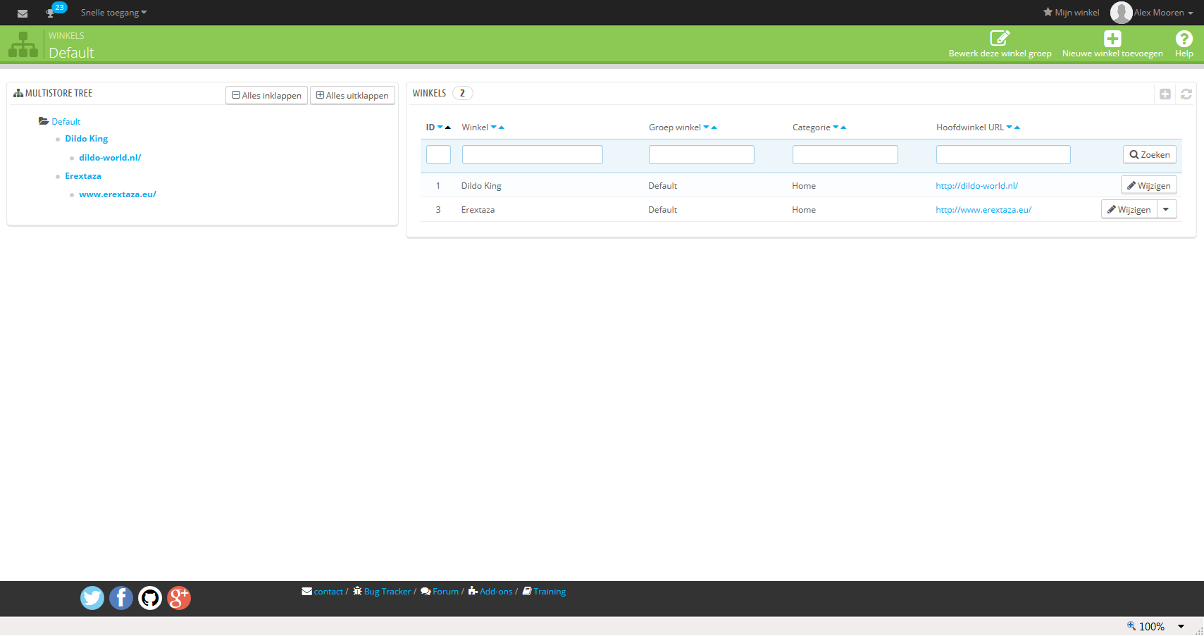

usage note:
ps can get 'very' confused and create issues with items in cart being lost.
so if you use non-www to www
in preferences-->seo &  urls-->scroll down
make sure that shop and ssl domain has the  www.
(this  needs to be done if also if you do the revers, www to non-www)
