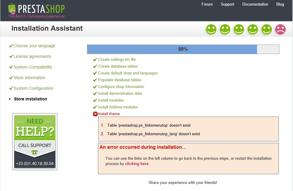

needsomehelp Posted June 4, 2014 Share Posted June 4, 2014 when i install the prestashop v1.6.0.7,I've got a problem.when it gone the 89%, it showed: Table 'prestashop.ps_linksmenutop' doesn't exist Table 'prestashop.ps_linksmenutop_lang' doesn't exist i've tried too many times, I don't know how to solve it, please help me. thanks. here is my ov version:CentOS release 6.5 (Final) 64bitLinux version 2.6.32-431.1.2.0.1.el6.x86_64 ([email protected]) (gcc version 4.4.7 20120313 (Red Hat 4.4.7-4) (GCC) ) #1 SMP Fri Dec 13 13:06:13 UTC 2013nginx:1.6.0PHP 5.3.28 (cli) (built: Jun 3 2014 20:40:04)Copyright © 1997-2013 The PHP GroupZend Engine v2.3.0, Copyright © 1998-2013 Zend Technologies with Zend Guard Loader v3.3, Copyright © 1998-2010, by Zend Technologiesmysql Ver 14.14 Distrib 5.5.37, for Linux (x86_64) using readline 5.1Connection id: 6Current database:Current user: root@localhostSSL: Not in useCurrent pager: stdoutUsing outfile: ''Using delimiter: ;Server version: 5.5.37-log Source distributionProtocol version: 10Connection: Localhost via UNIX socketServer characterset: utf8Db characterset: utf8Client characterset: utf8Conn. characterset: utf8UNIX socket: /tmp/mysql.sockUptime: 11 min 4 secThreads: 1 Questions: 6 Slow queries: 0 Opens: 33 Flush tables: 1 Open tables: 26 Queries per second avg: 0.009Zend_version:2.3.0 Link to comment Share on other sites More sharing options...
Gregory Roussac Posted June 4, 2014 Share Posted June 4, 2014 Hi, 1.6.0.7 is not out so how do you use it =) ? Your are probably using a git version and di not pull submodules. Regards Link to comment Share on other sites More sharing options...
needsomehelp Posted June 5, 2014 Author Share Posted June 5, 2014 Hi, 1.6.0.7 is not out so how do you use it =) ? Your are probably using a git version and di not pull submodules. Regards thanks for reply i download it from the github, i've changed to 1.6.0.6 last night, and the problem had been solved. thank you. Link to comment Share on other sites More sharing options...
