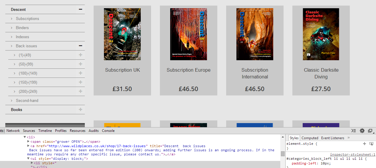

PSfever.com Posted June 5, 2014 Share Posted June 5, 2014 (edited) Hi, it's weird. Because it seems like Chrome is for some reason ignoring that line of code... When I put the same piece of code inside inspector-stylesheet in the dev. toolbar it works normally. See the attachement. Could you try placing it into global.css and turning cache off for the moment? Edited June 5, 2014 by PSfever.com (see edit history) Link to comment Share on other sites More sharing options...
CJH Posted June 5, 2014 Author Share Posted June 5, 2014 Hi, it's weird. Because it seems like Chrome is for some reason ignoring that line of code... When I put the same piece of code inside inspector-stylesheet in the dev. toolbar it works normally. See the attachement. Could you try placing it into global.css and turning cache off for the moment? Inserted at the end of global.css, cache turned off, cache cleared. No change in Firefox ... Your thumbnail shows exactly what I'm after! Link to comment Share on other sites More sharing options...
