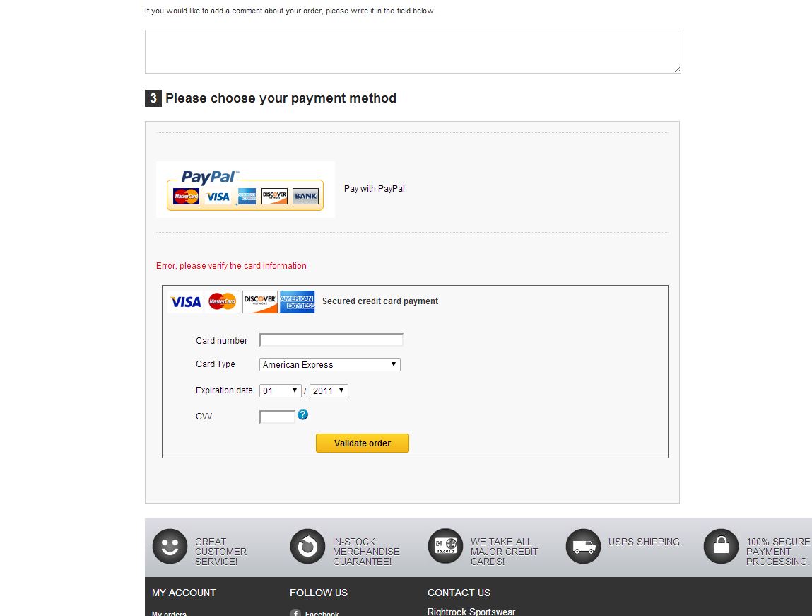

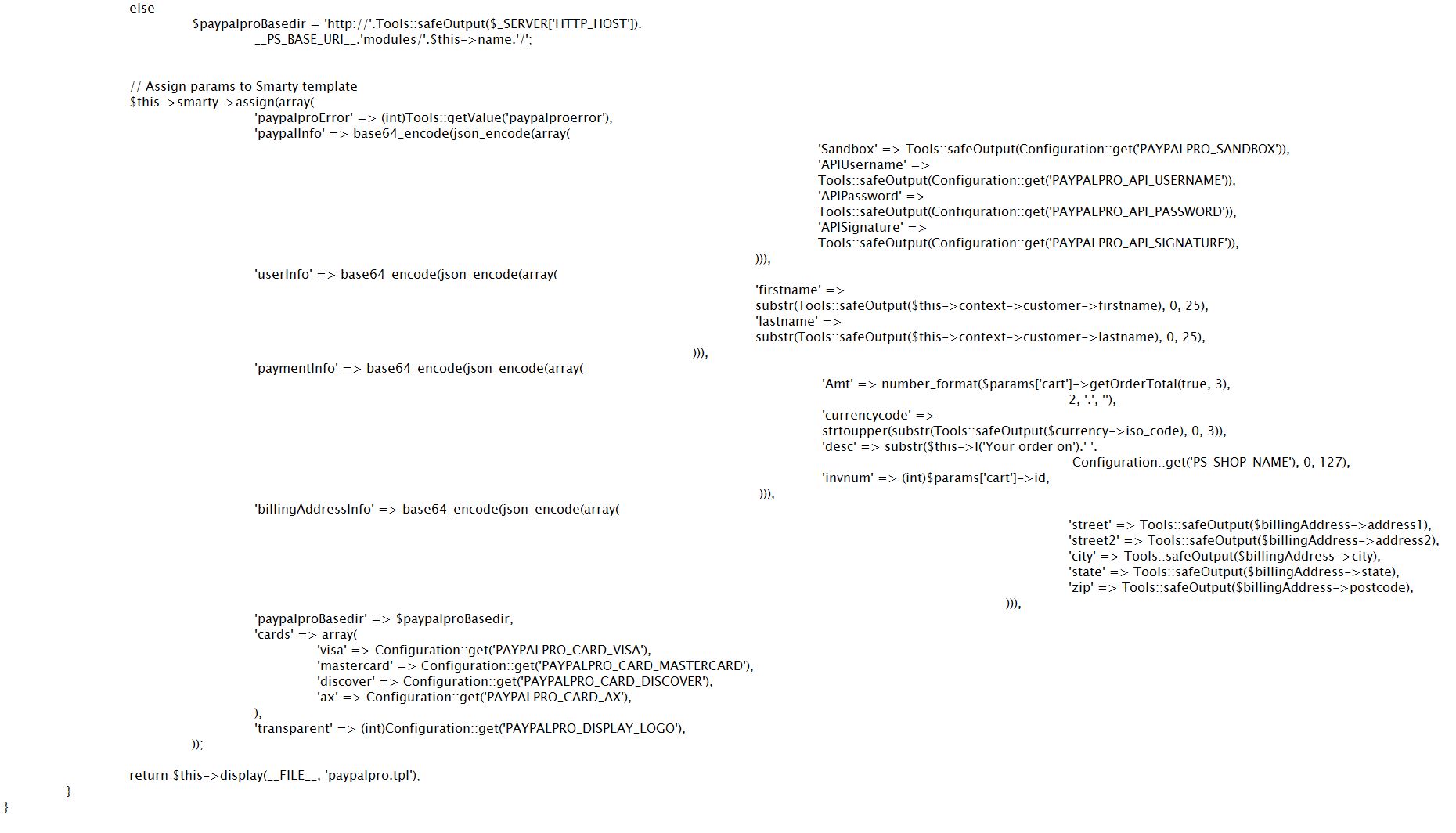

ShirtSeller Posted June 2, 2014 Share Posted June 2, 2014 PS Version 1.5.6.1 Purchased and installed today - no errors Configured with correct PayPal info, success Ran a test purchase and get an error in red; Error, please verify the card information I do have a pro plan with PayPal and they are assisting with the upgrade. They can see the request coming over and said it is failing because no country code is being sent over. We looked in the paypalpro.php and the PayPal tech thought that there should be a Country line where the billing address info is. I called and left a message for support but no call or email back as of yet. Can anyone confirm that this needs to be added to fix the problem? If so, what would the additional code be that needs to be added? Just a bit of frustration to vent but a $200+ module should just work....just saying. Thanks in advance - Joe Link to comment Share on other sites More sharing options...
