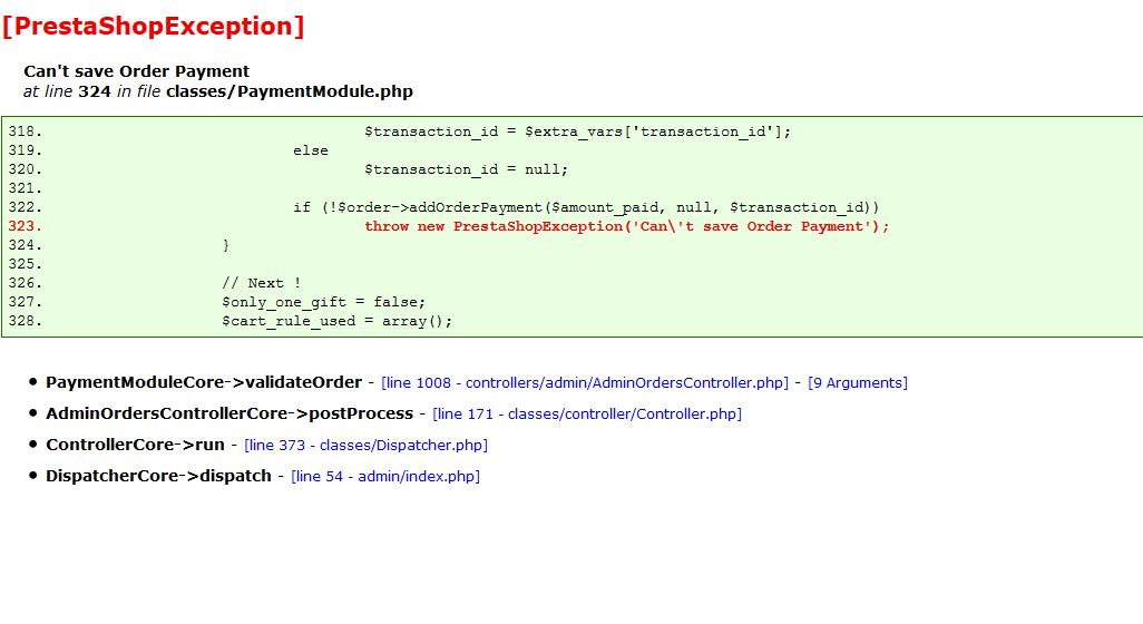

I need some help regarding orders in Prestashop 1.6.  From time to time issues appear when cart is transformed in orders. for eg orders's details are empty ( in database is not inserted as well , invoice are not inserted in database). From back-office I also get occasionally error attached  when a cart is transformed in order. My main concern is related with first error - unfortunately - in test I cannot reproduced it.

You probably need to debug a bit, here is the method
	public function addOrderPayment($amount_paid, $payment_method = null, $payment_transaction_id = null, $currency = null, $date = null, $order_invoice = null)
		$order_payment = new OrderPayment();
		$order_payment->order_reference = $this->reference;
		$order_payment->id_currency = ($currency ? $currency->id : $this->id_currency);
		// we kept the currency rate for historization reasons
		$order_payment->conversion_rate = ($currency ? $currency->conversion_rate : 1);
		// if payment_method is define, we used this
		$order_payment->payment_method = ($payment_method ? $payment_method : $this->payment);
		$order_payment->transaction_id = $payment_transaction_id;
		$order_payment->amount = $amount_paid;
		$order_payment->date_add = ($date ? $date : null);
		// Update total_paid_real value for backward compatibility reasons
		if ($order_payment->id_currency == $this->id_currency)
			$this->total_paid_real += $order_payment->amount;
		else
			$this->total_paid_real += Tools::ps_round(Tools::convertPrice($order_payment->amount, $order_payment->id_currency, false), 2);
		// We put autodate parameter of add method to true if date_add field is null
		$res = $order_payment->add(is_null($order_payment->date_add)) && $this->update();
		if (!$res)
			return false;
		if (!is_null($order_invoice))
			$res = Db::getInstance()->execute('
			INSERT INTO `'._DB_PREFIX_.'order_invoice_payment` (`id_order_invoice`, `id_order_payment`, `id_order`)
			VALUES('.(int)$order_invoice->id.', '.(int)$order_payment->id.', '.(int)$this->id.')');
			// Clear cache
			Cache::clean('order_invoice_paid_*');
		return $res;
It will return false either in the middle or at the end, try adding die('I got here'); after
if (!$res)
return false;
Of course, as it doesn't always happen, you will probably often see the message, but in case you don't sometimes, the problem resides here
And you have to inspect that other method
