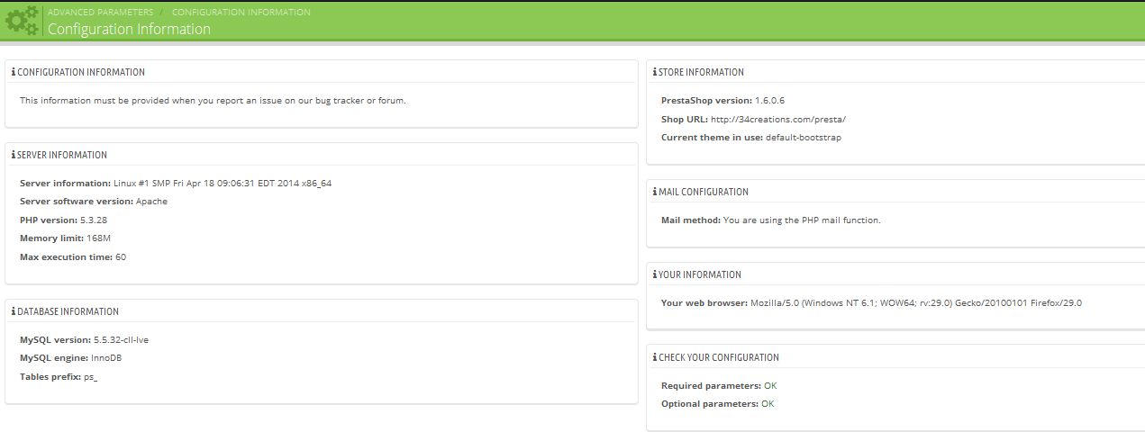

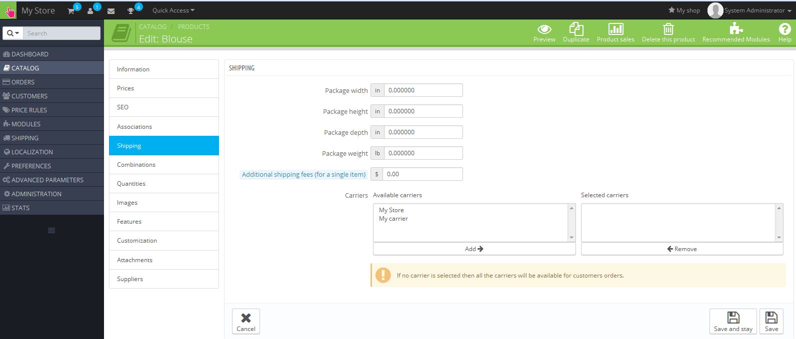

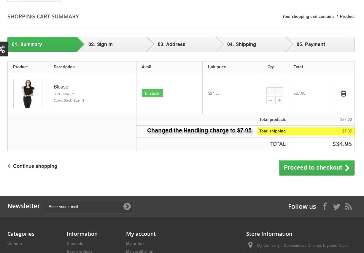

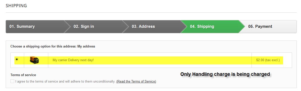

mpouliot34 Posted June 1, 2014 Share Posted June 1, 2014 (edited) Configuration information This information must be provided when you report an issue on our bug tracker or forum. Server informationServer information: Linux #1 SMP Fri Apr 18 09:06:31 EDT 2014 x86_64 Server software version: Apache PHP version: 5.3.28 Memory limit: 168M Max execution time: 60 Database informationMySQL version: 5.5.32-cll-lve MySQL engine: InnoDB Tables prefix: ps_ Store informationPrestaShop version: 1.6.0.6 Shop URL: http://plussizeappeal.ca Current theme in use: default-bootstrap Mail configurationMail method: You are using the PHP mail function. Your informationYour web browser: Mozilla/5.0 (Windows NT 6.1; WOW64; rv:29.0) Gecko/20100101 Firefox/29.0 Check your configurationRequired parameters: OK Optional parameters: OK Ok so I have been trying to figure out what is going on with the Shipping price for a while now. I have tested this in my working shop as well as on a fresh install on another domain which had no modification at all done to it. It seems that the cart is not taking into consideration the shipping rate that is assigned via carrier. As you can see from my screenshot the only thing that actually shows up in the shipping section is the handling price that is assigned but no actual shipping charge. I am really not sure of what I am doing wrong. I did the prestashop install from within my hosting providers (Namecheap) control panel for both domain. I am in process of uploading a prestashop install via ftp to further test on but in the meantime if someone could help me with this I would be very grateful. Edited June 1, 2014 by mpouliot34 (see edit history) Link to comment Share on other sites More sharing options...
