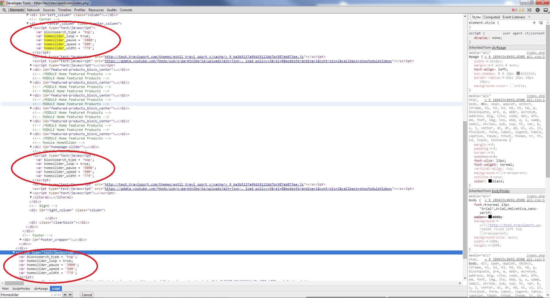

gr_fenix Posted June 2, 2014 Author Share Posted June 2, 2014 I replaced the directory JS from default template to my custom template and non works. Now I want to view the noConclict. Anyway, viewing the site with firebug, I've noticed that there are 3 JS calling to the homeslider module (I attach screenshot file) Link to comment Share on other sites More sharing options...
