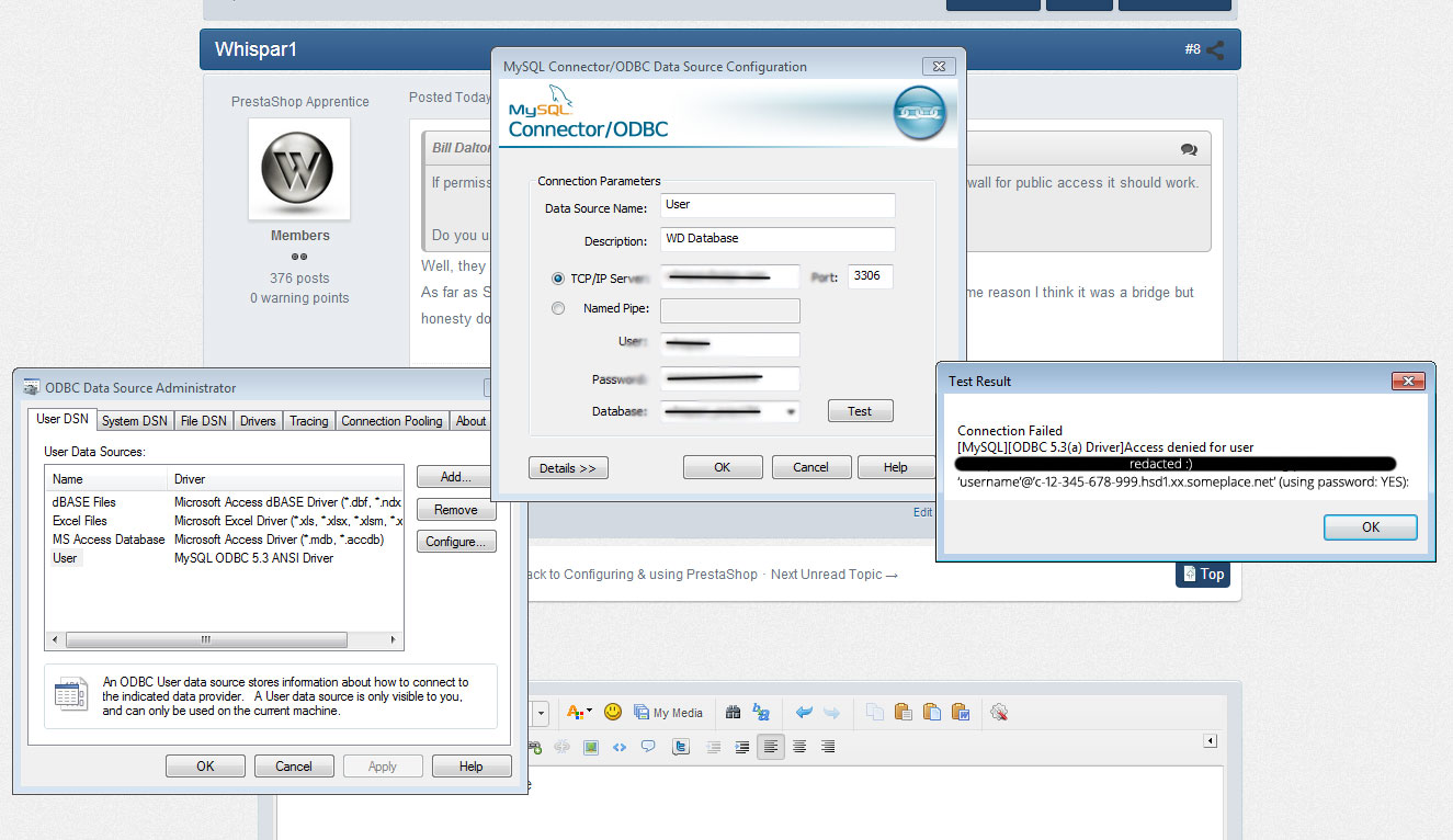

Whispar1 Posted May 21, 2014 Author Share Posted May 21, 2014 (edited) Yeah - having issues connecting. I added by IP through mysql remote and access is still denied. Host looked it over and said permissions are okay on their end so I am not sure what is going on... Should I look at setting up a mysql bridge?? this is squirly for me (pun intended) Edited May 21, 2014 by Whispar1 (see edit history) Link to comment Share on other sites More sharing options...
Bill Dalton Posted May 21, 2014 Share Posted May 21, 2014 If permissions are setup ... and your host is sure that port 3306 is enable for their firewall for public access it should work. Do you use Store Manger with a direct connection? Link to comment Share on other sites More sharing options...
Whispar1 Posted May 21, 2014 Author Share Posted May 21, 2014 If permissions are setup ... and your host is sure that port 3306 is enable for their firewall for public access it should work. Do you use Store Manger with a direct connection? Well, they say it is enabled - not sure how to test it...... As far as SM, I was months ago and I do not have it on my machine any more. For some reason I think it was a bridge but honesty don't remember. Link to comment Share on other sites More sharing options...
Whispar1 Posted May 21, 2014 Author Share Posted May 21, 2014 See anything off here? I have 3 drivers (sql and unicode) I can use if the ANSI is an issue Link to comment Share on other sites More sharing options...
Bill Dalton Posted May 21, 2014 Share Posted May 21, 2014 If you have windows telnet installed, (and who doesn't ), just type in the run command, telnet server_host 3306 If telnet hangs or the connection is refused, the port is blocked, if you get a connection and some garbage characters, the port is open. Link to comment Share on other sites More sharing options...
Bill Dalton Posted May 21, 2014 Share Posted May 21, 2014 (edited) Ok, that looks good, that is the response you should receive if proper privileges are not granted to the user. So you just need to give proper access. I would say your local computer is set, you just need to give correct access to the user at your host. Your port access appears to be all setup. Edited May 21, 2014 by Bill Dalton (see edit history) Link to comment Share on other sites More sharing options...

Whispar1 Posted May 21, 2014 Author Share Posted May 21, 2014 (edited) Nope - port blocked with telnet... stay tuned Not sure about SSH Edited May 21, 2014 by Whispar1 (see edit history) Link to comment Share on other sites More sharing options...

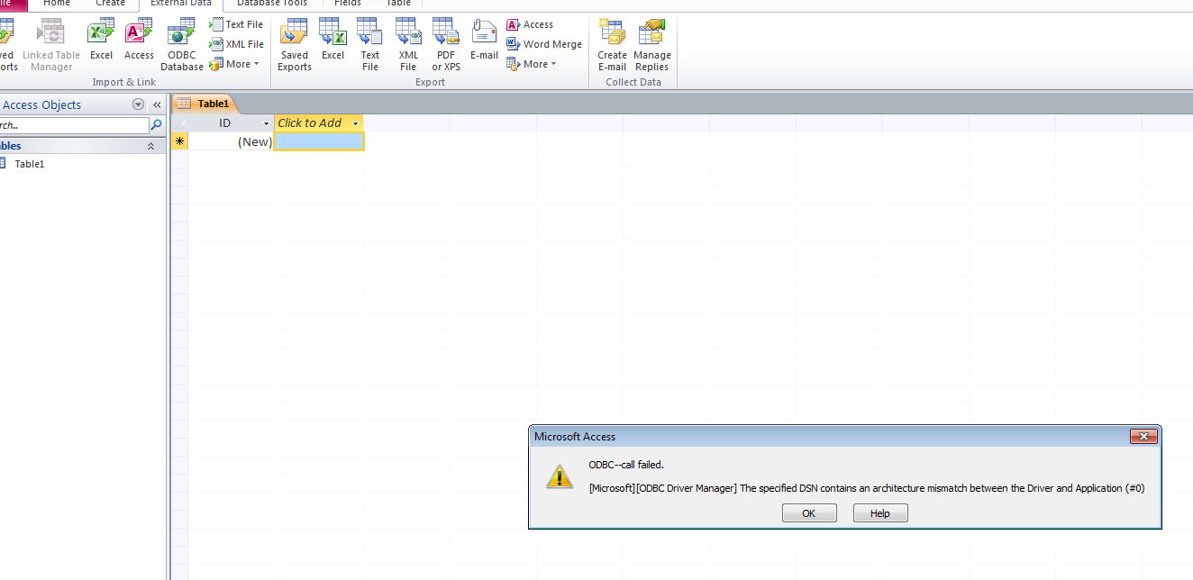

Whispar1 Posted May 21, 2014 Author Share Posted May 21, 2014 Do the same thing with ODBC, choose to link. A box will popup asking for file access, choose "Machine Access" and then choose the ODBC User you created above. Good Lord!.... another error Link to comment Share on other sites More sharing options...
Bill Dalton Posted May 21, 2014 Share Posted May 21, 2014 (edited) Are you using a 64 bit Access application and a 32 bit ODBC driver? Added: Or the other way around ... Edited May 21, 2014 by Bill Dalton (see edit history) 1 Link to comment Share on other sites More sharing options...
Whispar1 Posted May 21, 2014 Author Share Posted May 21, 2014 Yup - 32Bit Access and 64 bit driver..... Downloaded correct version now all is well Link to comment Share on other sites More sharing options...

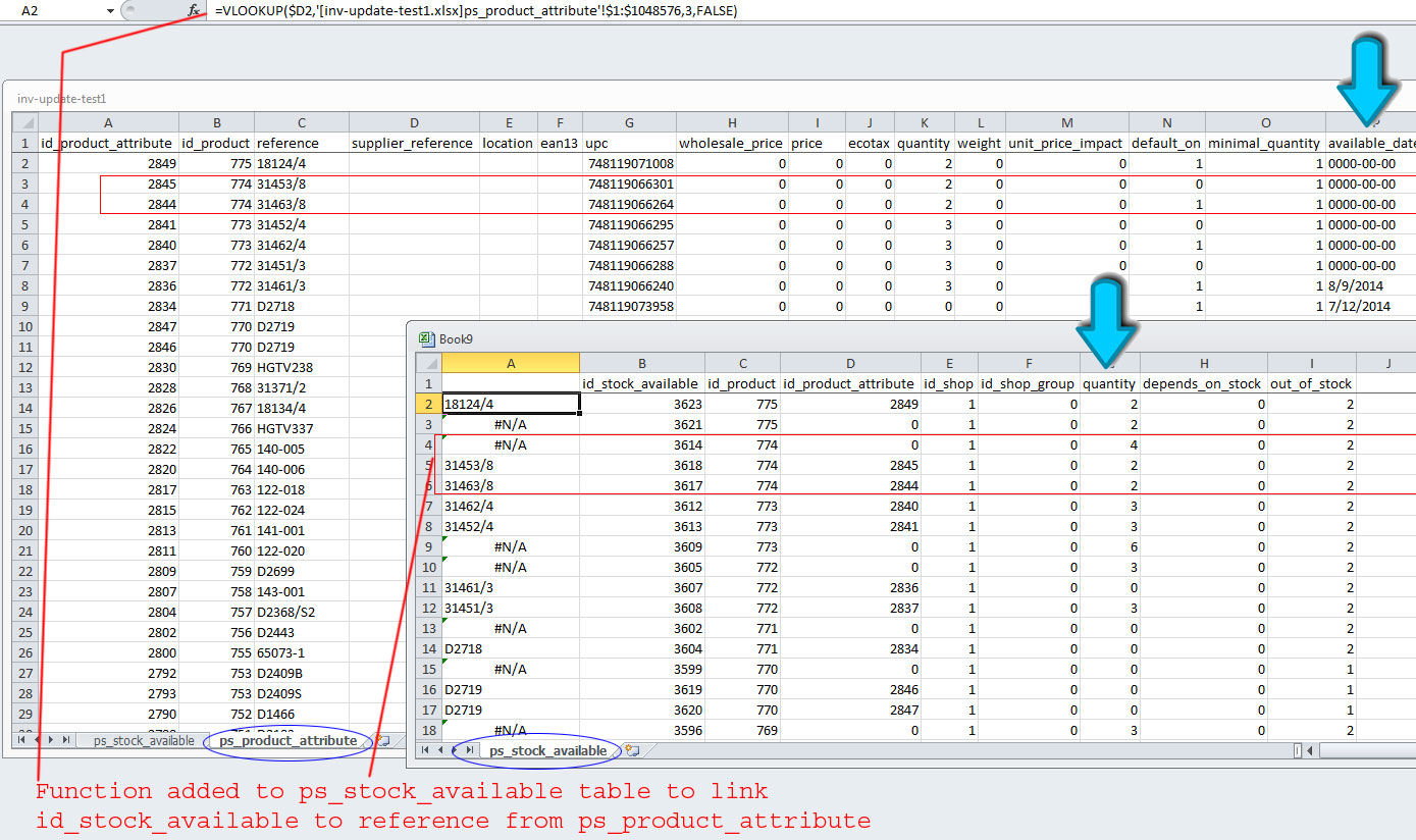

Whispar1 Posted May 22, 2014 Author Share Posted May 22, 2014 For some reason, I can not get a vlookup function to return a value other than NA. I am trying to link the reference number in my spreadsheet to the id_product_attribute from ps_product_attribute (downloaded as a csv and imported into a spreadhseet)..... I use vlookups all the time flawlessly - I have no idea why this is happening.... Does VB have a similar type function where I can link these items or is this a losing battle? Link to comment Share on other sites More sharing options...
Bill Dalton Posted May 23, 2014 Share Posted May 23, 2014 To create a join in MS, you drag the tables into the query designer, and than drag the field in table "A" you wish to join to the field in Table "B" that matches. I really can't explain it better than I already have in post #26. Link to comment Share on other sites More sharing options...
Whispar1 Posted May 23, 2014 Author Share Posted May 23, 2014 Sorry Bill - just voicing a little frustration...Your instructions are quite clear - I just fixed the excel issue so am on my way... just have some bugs to work out. Now back to our regularly scheduled program. Link to comment Share on other sites More sharing options...
