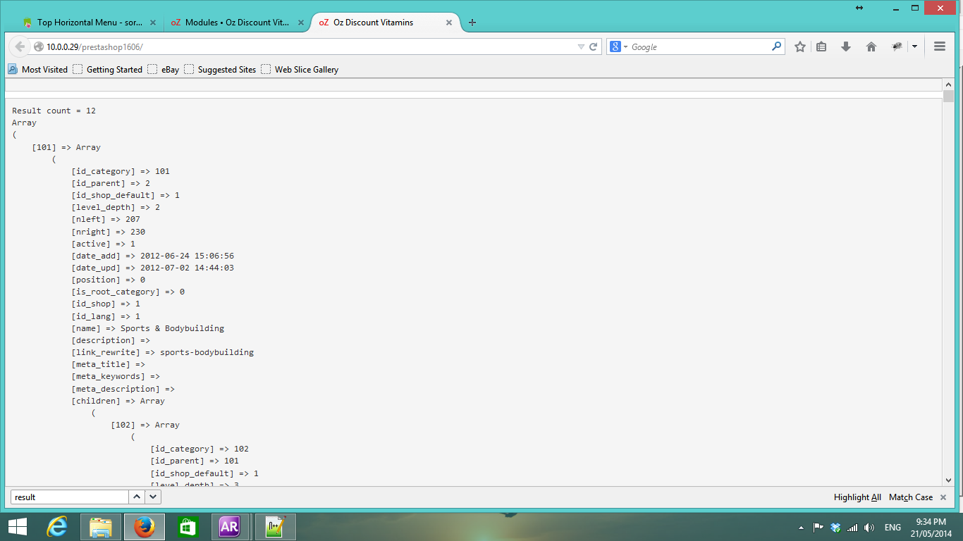

markb13 Posted May 21, 2014 Author Share Posted May 21, 2014 Hi I tried the above change to sort order ... the array ends up empty after the sql call (see attached before and after echo data) whereas data is in the $categories array before the change. I'll try and decipher the full sql statement to see if any obvious issue. Cheers Mark Link to comment Share on other sites More sharing options...
vekia Posted May 21, 2014 Share Posted May 21, 2014 in file: classes/Category.php change '.($sql_sort != '' ? $sql_sort : ' ORDER BY c.`level_depth`).' to: '.($sql_sort != '' ? $sql_sort : ' ORDER BY c.`level_depth` ASC, cl.`name` ASC').' 1 Link to comment Share on other sites More sharing options...
markb13 Posted May 21, 2014 Author Share Posted May 21, 2014 Still same result .. nothing in the array when I add the above. Will check out more tomorrow and run the sql statement against the database from a separate php file. Many thanks for your input Regards Mark Link to comment Share on other sites More sharing options...
markb13 Posted May 21, 2014 Author Share Posted May 21, 2014 Hi Vekia I checked the code after the sql statement has executed and dumped the array, and the data is moved to the array indexed by the current root category for the menu. All the other categories are then children of this category stored by their category_id. So even if the sql sorted by name they would be scambled when stored in this array. I think the solution is to write a separate function based on the existing one and only call this from blocktopmenu.php, but store the child categories differently ie. in the order I want based on name not category_id (or sort the children based on name). I may not get to this today but will let you know how I go. Regards Mark Link to comment Share on other sites More sharing options...
