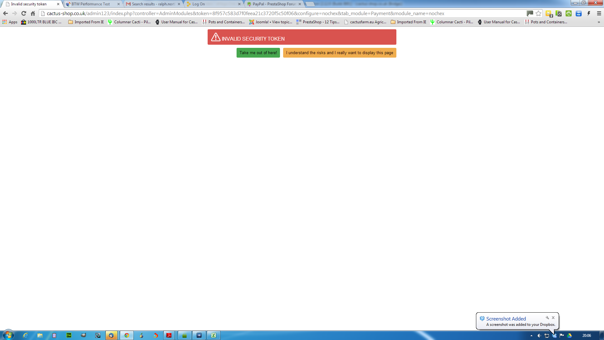

Ralph Northcott Posted May 20, 2014 Share Posted May 20, 2014 Trying to install Nochex on 1.6, I get the following error screen. See screenshot attachment. I have no idea what is wrong. I then get this message: Notice on line 103 in file /home/wwwcactu/public_html/modules/nochex/nochex.php[8] Undefined property: nochex::$test_mode Nochex however appears to be installed successfully, until a customer clicks to proceed to checkout. Then this message appears: Warning: fopen() [function.fopen]: Unable to access ../prestashop/modules/nochex/nochex_debug.txt in /home/wwwcactu/public_html/modules/nochex/nochex.php on line 135Warning: fopen(../prestashop/modules/nochex/nochex_debug.txt) [function.fopen]: failed to open stream: No such file or directory in /home/wwwcactu/public_html/modules/nochex/nochex.php on line 135File can't open Effectively, by installing the Nochex payment module, my entire shop is disabled. The shop works fine with Paypal and Moneybookers. I hope someone can tell me what is wrong. Link to comment Share on other sites More sharing options...
james.lugton Posted May 21, 2014 Share Posted May 21, 2014 Hello James from Nochex here. The issue looks like it is with your website, as I have tested the module in this version of Prestashop on my system, and it is working correctly. Link to comment Share on other sites More sharing options...
