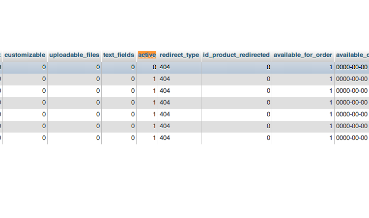

This time it is a products visualization problem, my module has to modify the active product state if the stocks goes to 0.
I'm watching the ps_product table, and the active field change to 0 when i click this option.
But the problem is something else change, and i don't know where.
view attached photos.
sumary....

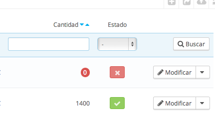

My module change the active field to 0 when the stock is 0, but the active button on the CSM do not change. So i have to  modify not only this active field on ps_product table.
Thanks in advance.
Okay solved - the table ps_product_shop also have the active field and need to be changed
