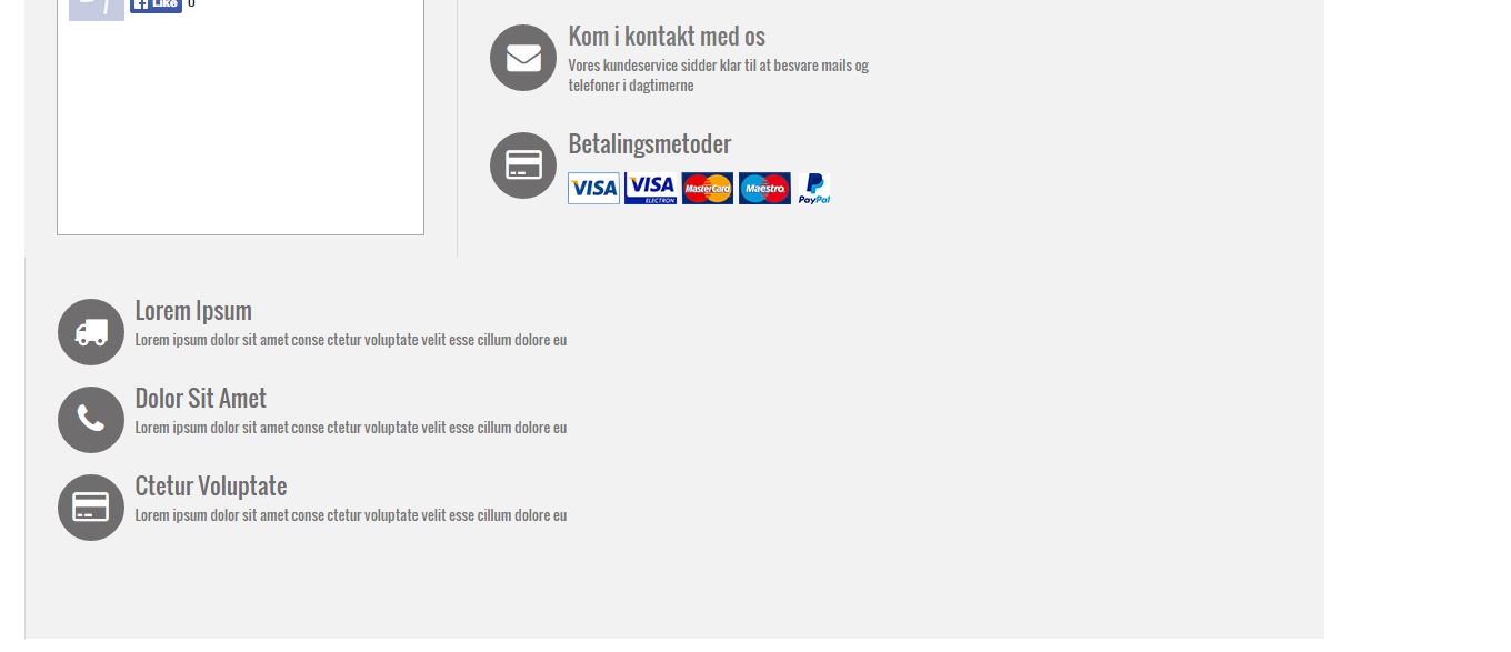

Karabisht Posted May 19, 2014 Share Posted May 19, 2014 have a question if it is even possible to add a Google+ badge in CMS block information?, next to facebook plugin. Since the Facebook social plugin is standard on the left side, there should surely be nice with the google+ badge on the right side too. Used the vekia's guide <link> to make a google+ badge via content box which works fine. When I try the same code in CMS block it dosent work. Anybody else besides me pushing more for Google than Facebook, how am I able to put the google code into custom CMS info block? 1 Link to comment Share on other sites More sharing options...

Karabisht Posted May 20, 2014 Author Share Posted May 20, 2014 (edited) hello you don't have to use custom hooks. you can achieve it without custom hooks. you can use default hooks in prestashop, in this case you can use displayFooter hooks to achieve particular effect. let me know what exactly you want to add and where, i will prepare code for you :-) I like it to look something like this. Do you need the google code? Regards, thank you for helping me out. Edited May 20, 2014 by Karabisht (see edit history) Link to comment Share on other sites More sharing options...
vekia Posted May 21, 2014 Share Posted May 21, 2014 ok, so the easiest thing is: disable these original contents (CUSTOM CMS INFORMATION BLOCK - just disable this module!), and in html block pro module, in dispalyHome hook create two boxes. first one with code: <div id="cmsinfo_block"> <div class="col-xs-6"><ul> <li><em class="icon-truck" id="icon-truck"></em> <div class="type-text"> <h3>Lorem Ipsum</h3> <p>Lorem ipsum dolor sit amet conse ctetur voluptate velit esse cillum dolore eu</p> </div> </li> <li><em class="icon-phone" id="icon-phone"></em> <div class="type-text"> <h3>Dolor Sit Amet</h3> <p>Lorem ipsum dolor sit amet conse ctetur voluptate velit esse cillum dolore eu</p> </div> </li> <li><em class="icon-credit-card" id="icon-credit-card"></em> <div class="type-text"> <h3>Ctetur Voluptate</h3> <p>Lorem ipsum dolor sit amet conse ctetur voluptate velit esse cillum dolore eu</p> </div> </li> </ul></div> and second with code: <div class="col-xs-6"> YOUR GOOGLE BADGE CODE HERE </div> </div> and that's all :-) 1 Link to comment Share on other sites More sharing options...
