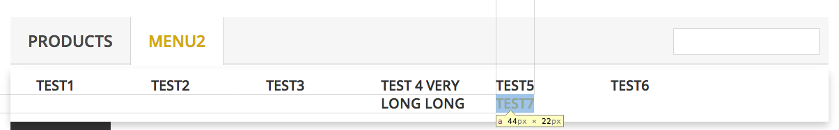

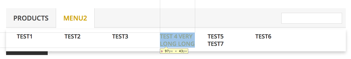

PrestaUser348 Posted May 10, 2014 Share Posted May 10, 2014 I would like to how to correct the CSS for block_top_menu in default bootstrap theme so items get correctly displayed. currently if a you have very long category name, the following categories gets stacked together as shown in the screenshots Menu item TEST7 should not be under item TEST5 but to the left of it Link to comment Share on other sites More sharing options...

vekia Posted May 10, 2014 Share Posted May 10, 2014 there are two possibilities. 1) increase width of the columns - this will work only if number of subcategories will be the same 2) you have to define height param for each <ul> element -it must be the same for each block of categories. at the moment there is no other solution, unfortunately. Link to comment Share on other sites More sharing options...

vekia Posted May 25, 2014 Share Posted May 25, 2014 it's a superfish-modified css: themes/default-bootstrap/css/modules/blocktopmenu/css/superfish-modified.css increase width param in: .sf-menu > li > ul > li { float: left; width: 20%; padding-right: 15px; } Link to comment Share on other sites More sharing options...
