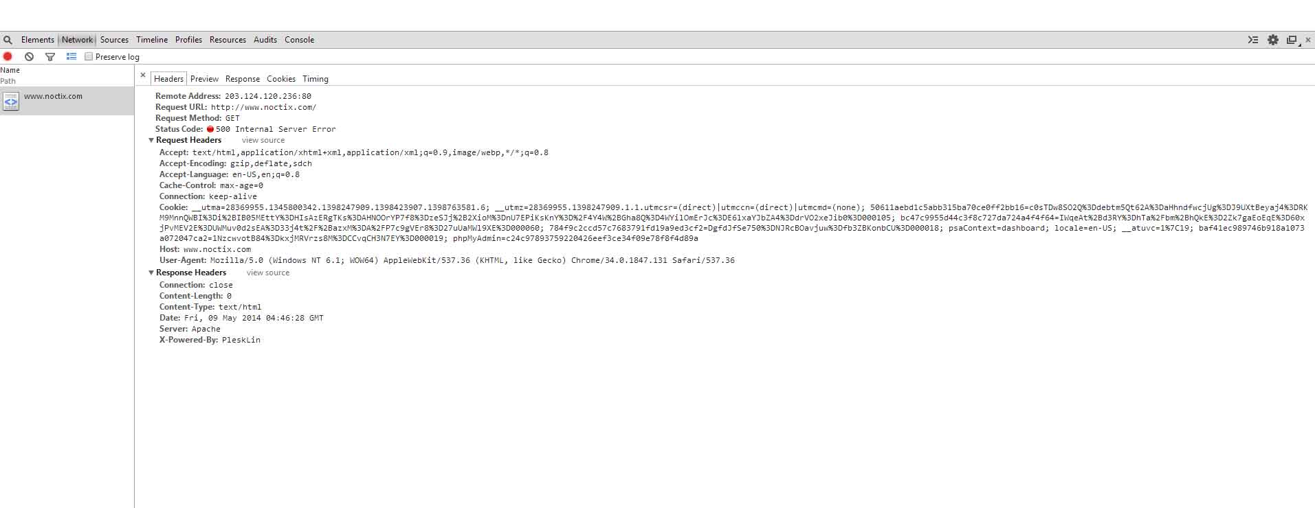

aau Posted May 9, 2014 Share Posted May 9, 2014 (edited) I'm trying to move my test site in a subfolder to the root domain but after all the necessary changes I only see white screens from both the front and back office. I can't get any log errors to show either. Only error I can find is through the browser - see attached image. If anyone can point me to a solution I would appreciate that. Thanks Alex UPDATE After the migration did not work, I moved the files back into it's original place and tried to just change the folder name to see if that worked. Of course it did not...same results of white pages for both front and back offices. Is there something else I'm suppose to change in the tables other than ps_shop_url?? Edited May 13, 2014 by aau (see edit history) Link to comment Share on other sites More sharing options...

NemoPS Posted May 9, 2014 Share Posted May 9, 2014 So no back office either? and no errors after enabling error reporting (in defines.inc.php)? Link to comment Share on other sites More sharing options...

vekia Posted May 9, 2014 Share Posted May 9, 2014 have you got an access to php error log file and to apache error log file? perhaps you've got them somewhere on your hosting account management script, it's worth to check it due to the fact, that you've got internal server error. Link to comment Share on other sites More sharing options...
