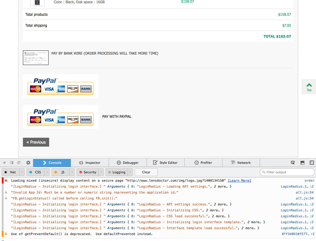

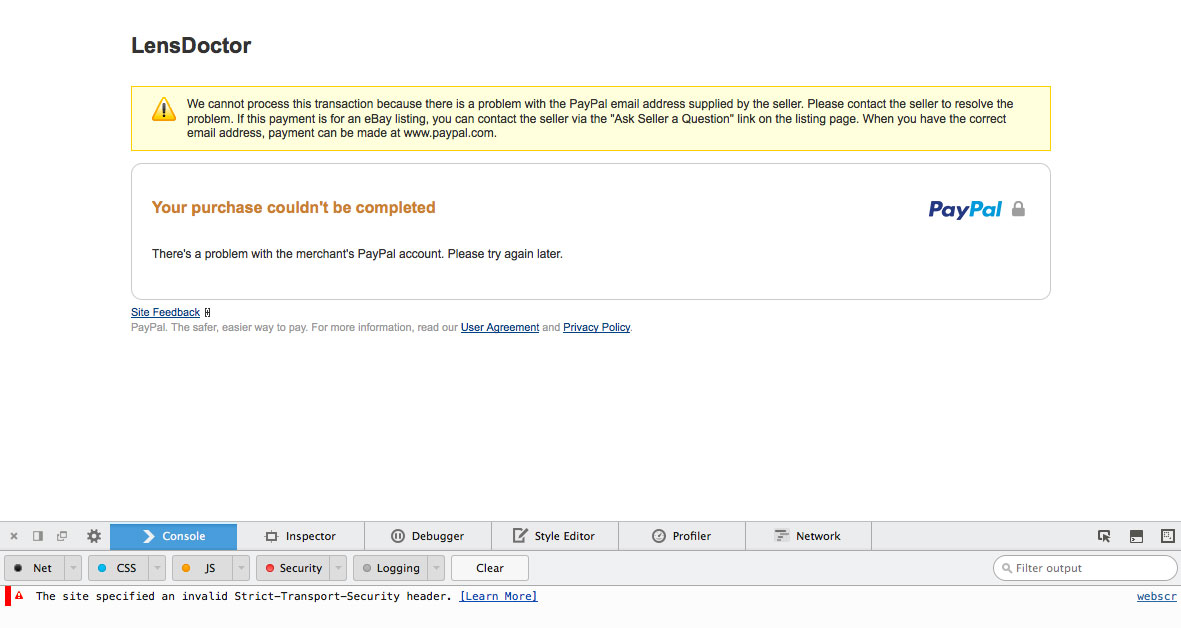

lensdoctor Posted August 16, 2014 Share Posted August 16, 2014 PayPal USA/Canada/Mexico 1.3.7 Problem I've tried it out with Prestashop 1.5.6.2 - 1.6.0.9, all clean installs. I'm making a second round of clean installs without using only the default theme. I'm at 1.6.0.6 with the PayPal USA/Canada/Mexico 1.3.7 I'm not sure, but I believe that is the same module being bundled with all the Prestashop versions I've been trying. I've been on the phone with PayPal support, 3 different times, for more than a couple hours all together. I opened Firebug web console and captured the screen for you to see. I need to say one thing, there is NO PROBLEM with the seller email and believe me, I've tried all options there. Link to comment Share on other sites More sharing options...
lensdoctor Posted August 16, 2014 Share Posted August 16, 2014 Sorry folks! The answer is here on the Forum only it's hard to find. An issue of this magnitude should be more prominently displayed. The problem I have been experiencing has been solved. When entering your credentials, in the field "PayPal Business Account:" you should enter your email address. 1 Link to comment Share on other sites More sharing options...
