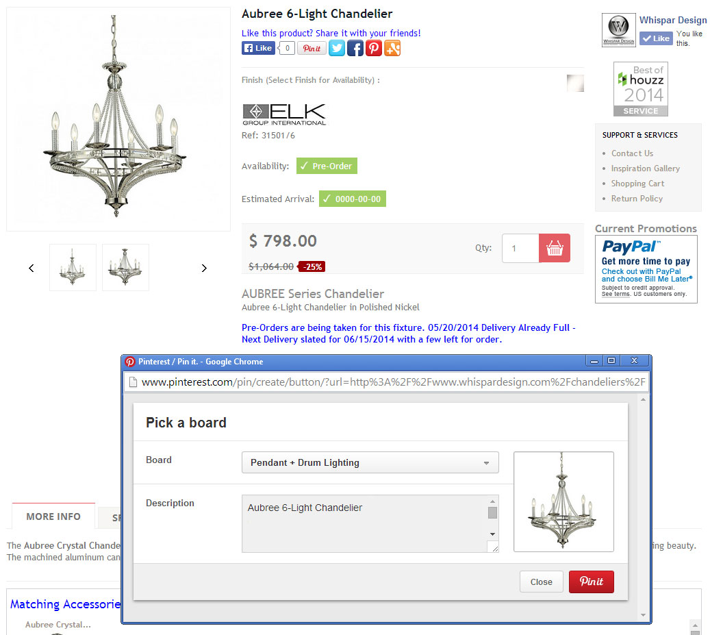

But this does not recognize description_short and as a result, does not pull ANY description, just the title tag. Can anyone see what I might be missing here?

Thank You for trying Nemo - unfortunately it did not work. It is just very strange that {$product->description} works fine but {$product->description_short} does not. Makes no sense to me, especially since the facebook share adds the short description, but from product schema tag.
I have moved the script and the sharing tool to different locations on the product page and different hooks. Still the same problem - description works - description_short does not.

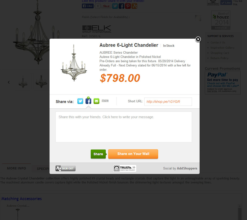

In fact, every single share (email, facebook, twitter, etc) all have the short description i.e. this example
Short Description: Aubree 6-Light Chandelier in Polished Nickel
http://www.whispardesign.com/chandeliers/646-aubree-6-light-chandelier
