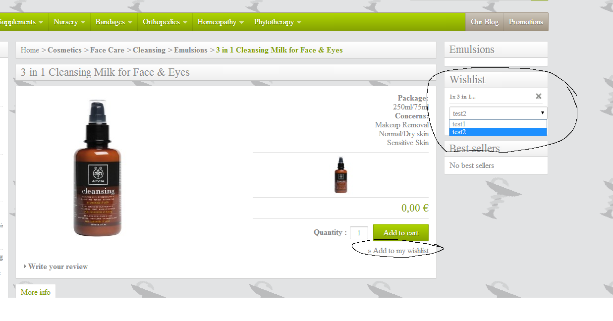

wakabayashi Posted July 21, 2014 Share Posted July 21, 2014 Hello I have also problems with this module (Version 1.0). I work with new 1.6.0.8. I deleted all theme specific folders. So in fact i work with a clean wishlist-module. I can delete products. But how is it possible to add products on Wishlist number 2? Will there soon be an update? It seems that many people have trouble with this module... Link to comment Share on other sites More sharing options...
system_error86 Posted July 21, 2014 Share Posted July 21, 2014 Do you have set the module in front page like image? if you create two or more wishlists, every time that you want to save a product in one of your wishlists first you must select which whishlist you want to add the product! Link to comment Share on other sites More sharing options...

system_error86 Posted July 22, 2014 Share Posted July 22, 2014 Hello again! Can you see the attached image that i have in the previous post? Can you see the list in dropdown menu into the circle i have drawn ? Link to comment Share on other sites More sharing options...

wakabayashi Posted July 22, 2014 Share Posted July 22, 2014 On 7/21/2014 at 10:17 PM, system_error86 said: Do you have set the module in front page like image? if you create two or more wishlists, every time that you want to save a product in one of your wishlists first you must select which whishlist you want to add the product! Thanks for your image. I dont have such a dropdown option. I customize my template. Where can i find the template for this dropdown menu? I want to add this on the wishlist page... Link to comment Share on other sites More sharing options...
system_error86 Posted July 22, 2014 Share Posted July 22, 2014 It is not a template my friend! This is that you see when you use this module. Do you use the default theme? if you use the default module it is difficult to show up this list! You must change the code of the css and maybe the tpl files! Could you send me a link of your site please? Link to comment Share on other sites More sharing options...
wakabayashi Posted July 24, 2014 Share Posted July 24, 2014 On 7/22/2014 at 9:52 PM, system_error86 said: It is not a template my friend! This is that you see when you use this module. Do you use the default theme? if you use the default module it is difficult to show up this list! You must change the code of the css and maybe the tpl files! Could you send me a link of your site please? Thanks for your answer. For me it was a template problem, since I never show right column on my template. But the way this works is useless for me. My customer can add products to wishlist only on category page. Its very annoying always to have to chose which wishlist. Should be a function under customer profil, where he can define where products should be added and then its saved until customers changes list again. But since this wishlist stuff is not very important for me. I will just remove the option to add a second wishlist Link to comment Share on other sites More sharing options...
system_error86 Posted July 24, 2014 Share Posted July 24, 2014 Yes ok! If yoy find how to remove this option please share it with me!! thank you Link to comment Share on other sites More sharing options...
wakabayashi Posted July 27, 2014 Share Posted July 27, 2014 On 7/24/2014 at 9:10 PM, system_error86 said: Yes ok! If yoy find how to remove this option please share it with me!! thank you I just remove the stuff from the template... I think this is much better than changing core-files of the module... Link to comment Share on other sites More sharing options...
