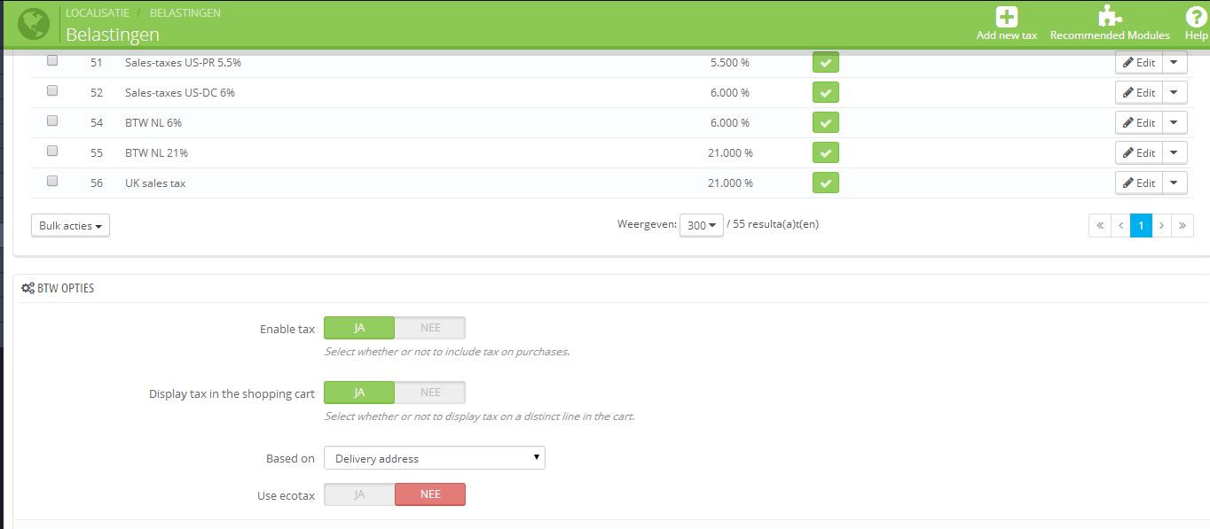

rvzoest Posted May 14, 2014 Share Posted May 14, 2014 (edited) Maybe now I am stupid but let me ask it for sure... I am stated in the Netherlands and I created a login as was I a customer in England which is part of the EU with 20% VAT. I have created the zone united kingdom with tax and tax rule so I should see the prices with 20% VAT ? Please correct me on this.. Edited May 14, 2014 by rvzoest (see edit history) Link to comment Share on other sites More sharing options...

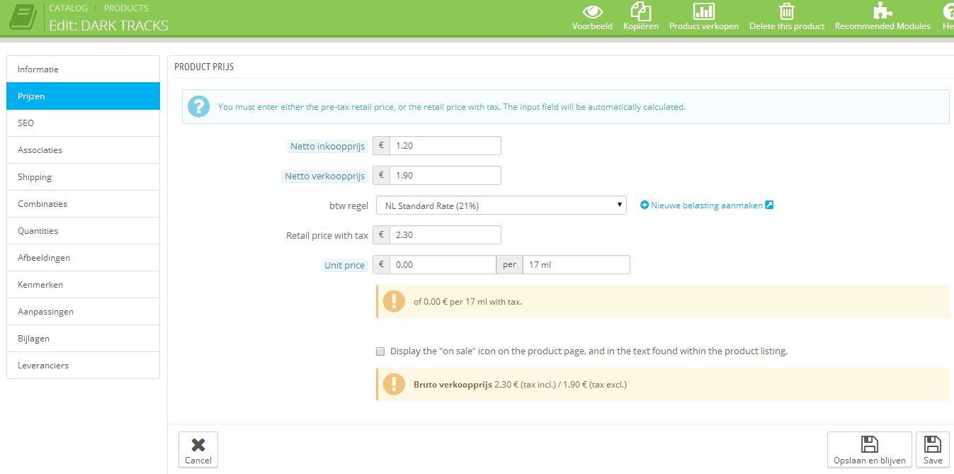

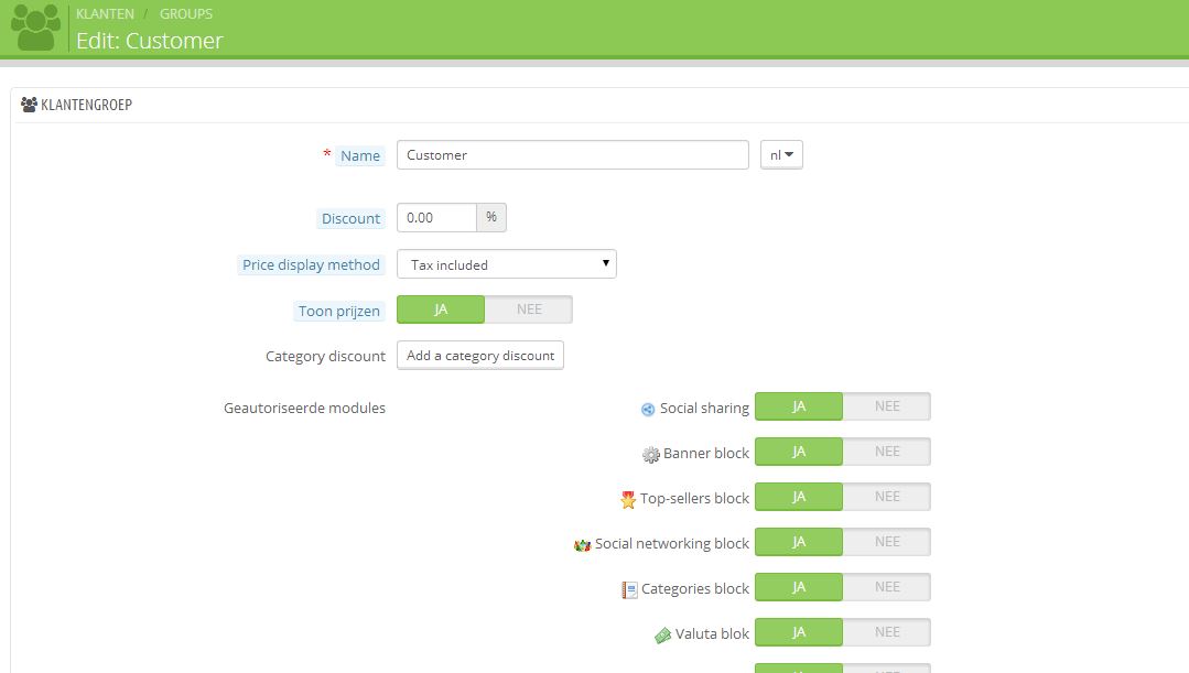

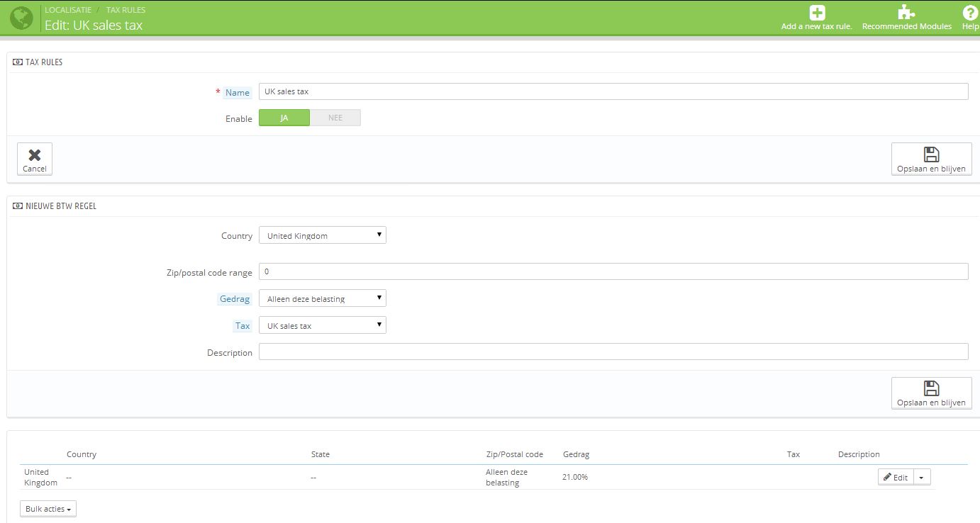

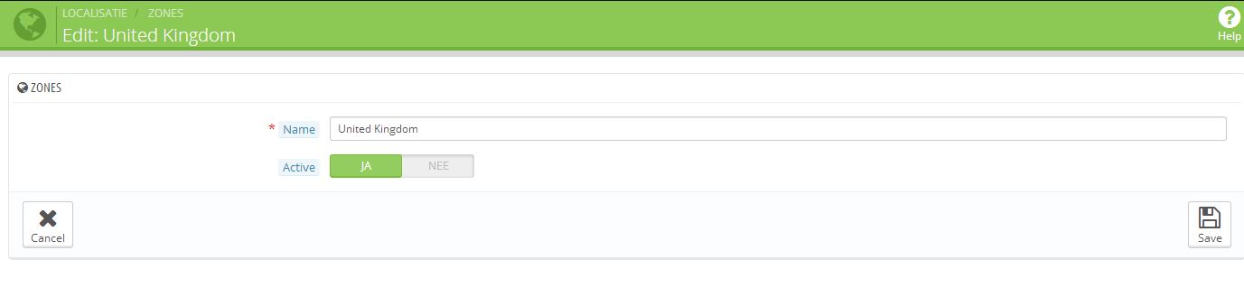

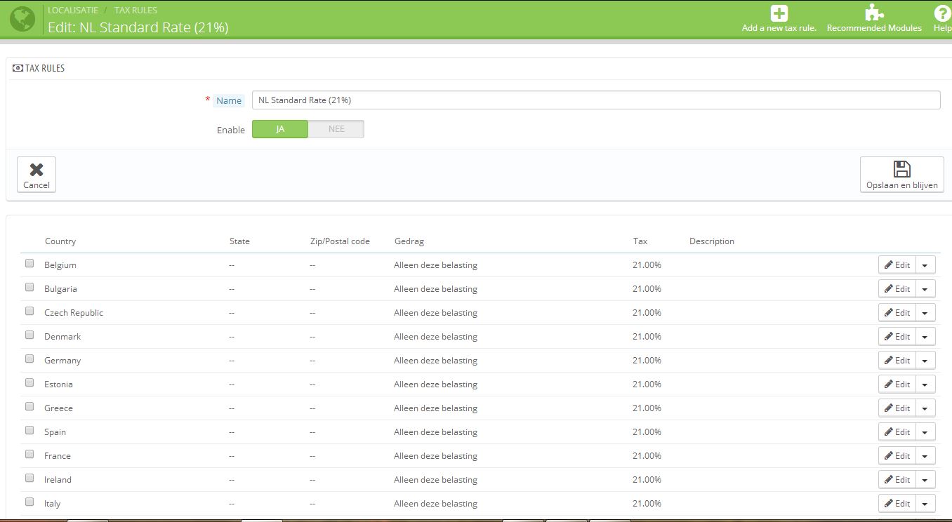

rvzoest Posted May 14, 2014 Share Posted May 14, 2014 Hi kerrianne42, thanks for replying. I have uploaded the screenshots as to my original post. I have setup the zone United Kingdom I have setup the Tax rate to 21% (I have altered it to 20% after the screenshot) I have created the Tax Rule uk sales tax and pointed it to United Kingdom and assigned uk sales tax to it and enabled it In all groups (customer etc..) I enabled tax as well. Link to comment Share on other sites More sharing options...
kerrianne42 Posted May 14, 2014 Share Posted May 14, 2014 Did you enable the tax rules on the prices tab of your products as well? Link to comment Share on other sites More sharing options...

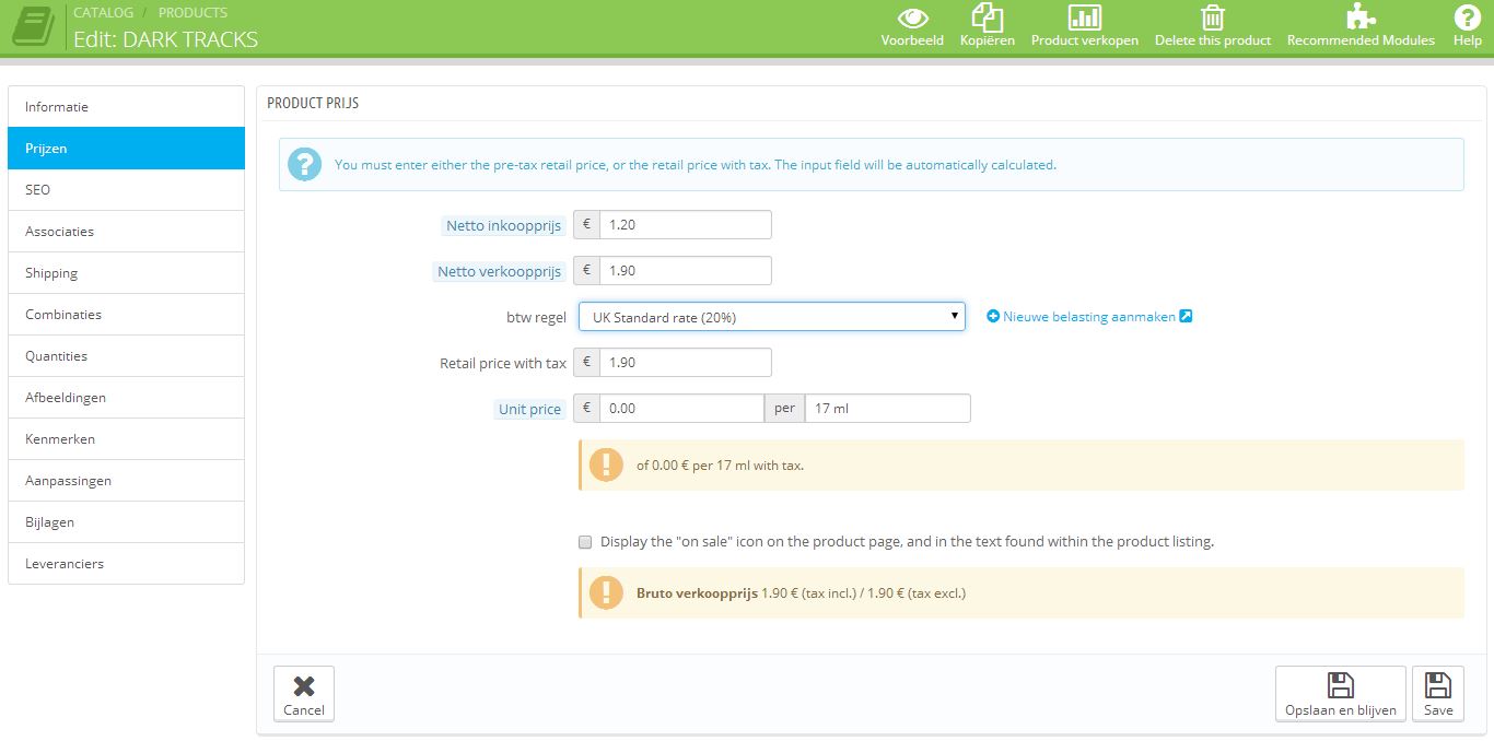

rvzoest Posted May 14, 2014 Share Posted May 14, 2014 Yes I have enabled the tax rules HOWEVER... I have been fiddling with the tax rates in the Product screen and it seems when I apply the UK tax rate the prices don't change?! Link to comment Share on other sites More sharing options...
kerrianne42 Posted May 14, 2014 Share Posted May 14, 2014 Applying the tax rules won't change the price in Back Office. You will see the tax applied in the front end during the check-out process, after the customer identifies their location. If they're in Brazil (for example), no EU tax applies. Try from the front and see if the tax rules are working. Link to comment Share on other sites More sharing options...
rvzoest Posted May 26, 2014 Share Posted May 26, 2014 Ok, problem solved! It seemed I overlooked the Tax rules INSIDE the country of origin you can apply the tax rates for other countries. The UK was not added to that list so it had no tax assigned to it. As for me this thread can be closed. Thanks all for sharing your knowledge in this one. Link to comment Share on other sites More sharing options...
