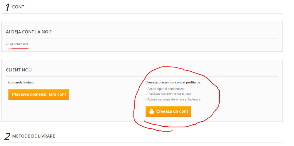

Hello, i`ve done this and now register is unavaible from Authentication button, but, if i come as guess on website and then i want to make a quick order i still have the option to create an account. How can i remove this posibility?
I use prestashop 1.6, this is website if u wanna check-out https://genti-de-marca.ro/quick-order
Thank you!
For the part you have marked you need to modify also the order-opc-new-account.tpl or if you use the eu legal style it would be the order-opc-new-account-advanced.tpl
Do you want to get rid of registered customers at all and only provide guest check out? If so you should also get rid of the "Autentificare" link on the upper right in your shop.
I have changed my OPC to only guest checkout and show the form to enter the address from the instant. To do so you have also to change the order-opc.js file.

can u, please, tell me what code i have to edit exactly?

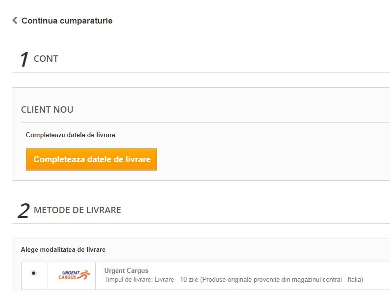

Later edit: For now i force costumers to select guest checkout, but is there a posibility to set is at default (no click on botton needed)?
How to get rid of "Autentificare" button from top right side of my page? What file i need to edit?

To get rid of "Completeaza datele de livrare" put the following code in the order-opc-new-account.tpl between {*    *}
Around line 9 you see this code:
						<p class="title_block">{l s='Instant Checkout'}</p>
						<p class="opc-button">
							<button type="submit" class="btn btn-default button button-medium exclusive" id="opc_guestCheckout"><span>{l s='Guest checkout'}</span></button>}
						</p>

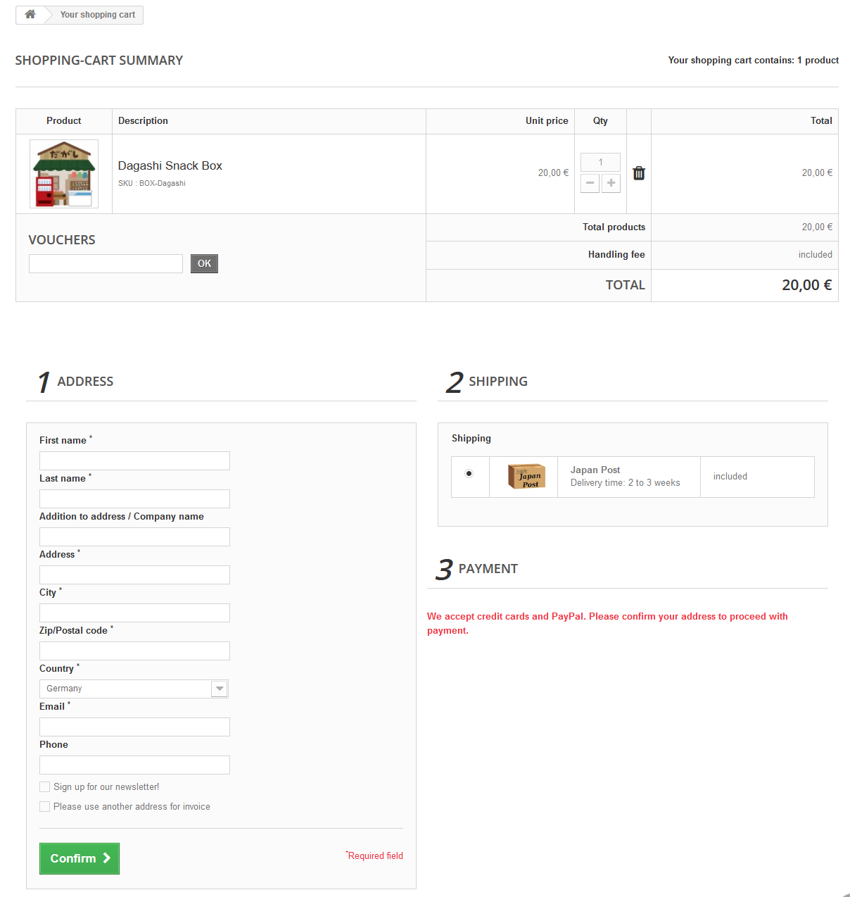

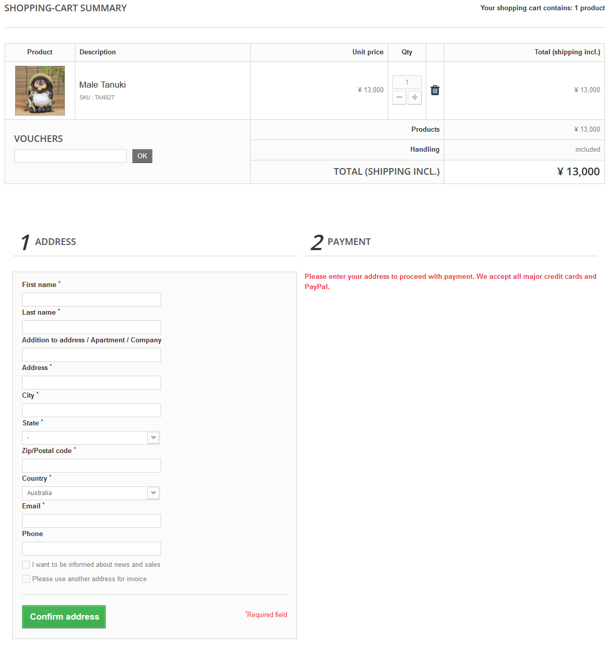

My checkout looks like the following:
For checking the exact steps I would need more time which I, unfortunately, hardly have at the moment but I attached all the files I changed so you can use them as a guide.
OPC-2-Column.zip
