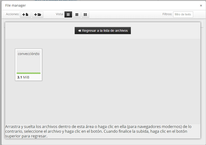

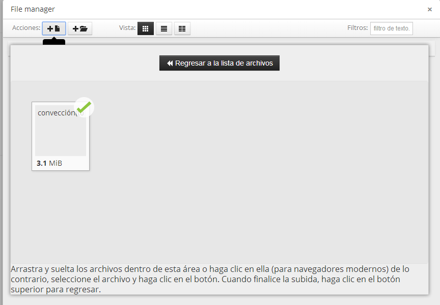

I'm having problems with the filemanager when I'm adding the product description.

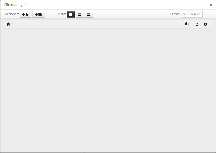

I try to upload something, it's uploaded correctly and when I'm try to add it to the product description, the file recently added just doesn't appear.
If I upload the file by FTP, it doesn't appear.
