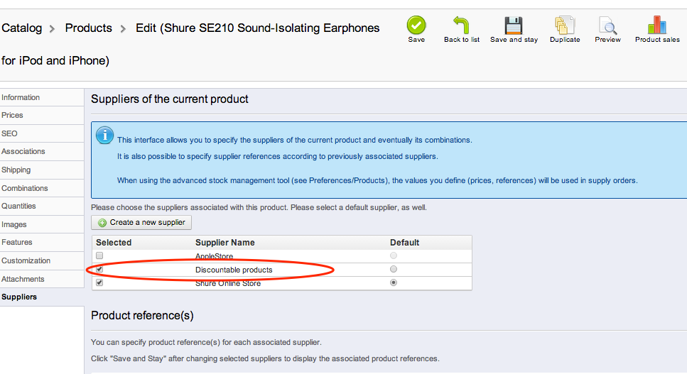

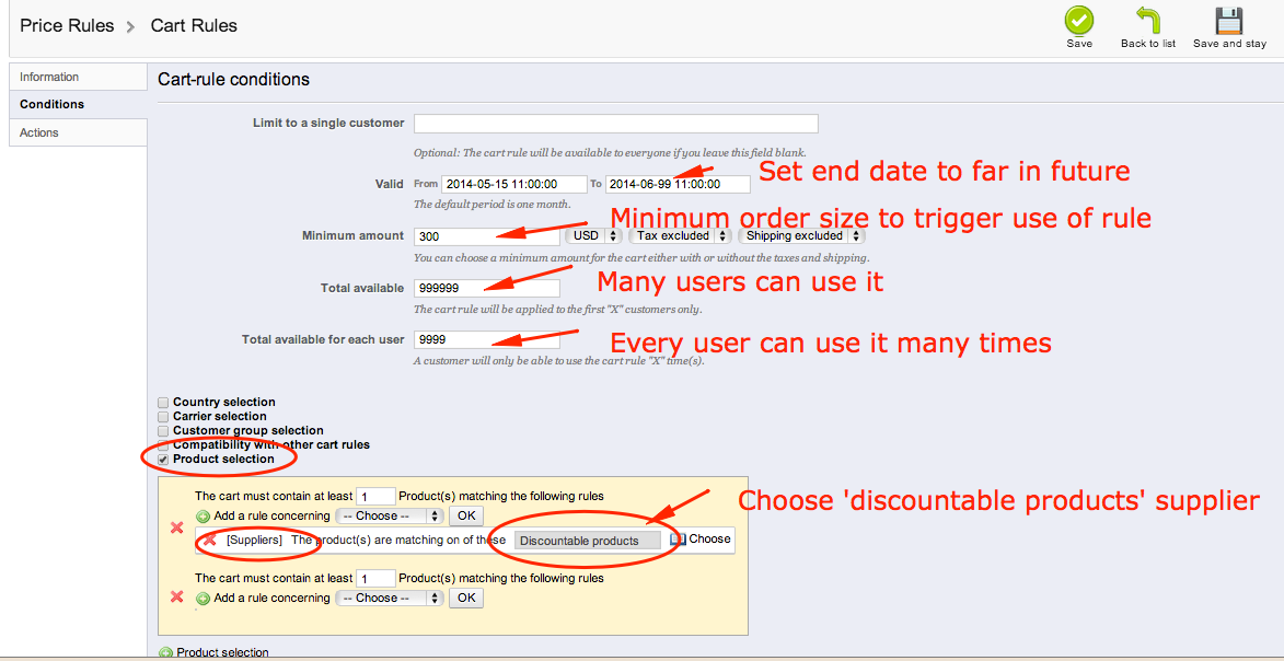

tracert Posted May 9, 2014 Author Share Posted May 9, 2014 Hi Pascal, thanks for your answer! In fact I do not use suppliers so I've just tried the following: I created an supplier 'discountable'. In one of the products (for testing) I've selected the 'discountable' supplier in the 'Suppliers' tab. Now I edited my '300€, 5% off' cart rule to the settings in the screenshot. I'm not sure if I understood your solution correctly because now when I add the product I've changed before to the customers cart and I get over 300€ there's still the discount calculated. Thank you! Link to comment Share on other sites More sharing options...

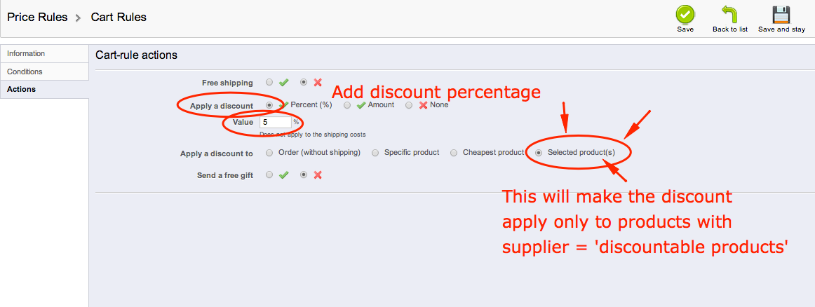

PascalVG Posted May 16, 2014 Share Posted May 16, 2014 Hi Mario, Think I solved it. We were actually very close with the first try. We actually only had to change the selection on the third tab of the cart rule.... Let me show: First we make a fake supplier 'discountable products' (address etc is not important, just need a new supplier we can use). Then we add this supplier to the products that can be discounted 5% when the total order size is say 300$. Do this for all products that can be discounted... Then we make a new cart rule: On tab 1, leave the code name empty, to automatically trigger the rule when it matches the criteria. On tab 2, we select "products that have a supplier discountable products' On tab 3, we DON'T select "order (without shipping)", but "Selected products". What does this do: It only gives the discount to the products that match the criteria (supplier = discountable products). Other products WON'T get discounted. See result here: I think this is what you wanted. Hope this helps, pascal. 2 Link to comment Share on other sites More sharing options...
