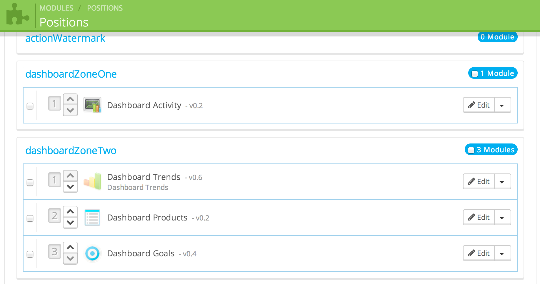

TTNZ Posted April 25, 2014 Author Share Posted April 25, 2014 (edited) Hi guys, The problem for me was due to the upgrade from 1.5.0.6 to 1.6.0.5. All my modules and there positions had to be reset to enable the back end dashboard to work. I went through the Modules - positions and looked at two key areas: dashboard-Zone1 and Zone2 were both empty so I had to transplant the modules for the dashboard into here and it worked perfectly. I still think I am missing something from here but I get all the dashboard stats I need for now. This worked for me so I can mark this solved :-) Edited April 25, 2014 by TTNZ (see edit history) Link to comment Share on other sites More sharing options...
