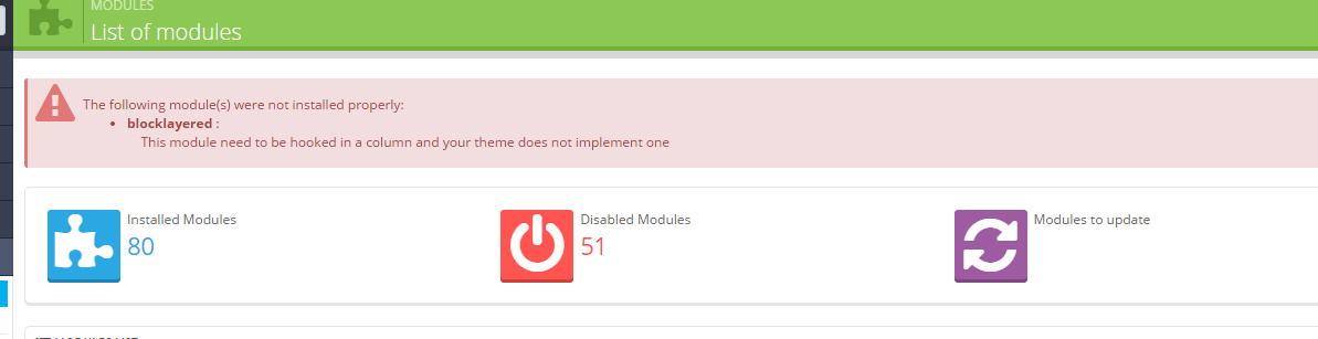

subwayside Posted October 26, 2014 Share Posted October 26, 2014 I also have the same issue anyone please help. How to install it without revert my backup. See attached screenshot Thanks Link to comment Share on other sites More sharing options...
prestamax Posted October 26, 2014 Share Posted October 26, 2014 I am having the same issue today. It was installed after installing prestashop. Then I was wondering why my layered module didn't show up tried to reinstall it and got this error message. Link to comment Share on other sites More sharing options...
prestamax Posted October 26, 2014 Share Posted October 26, 2014 ha ... found the solution. You need to go to preferences => themesthere click on advanced settings and activate one default column then you can install the module Link to comment Share on other sites More sharing options...
subwayside Posted October 26, 2014 Share Posted October 26, 2014 Thank you so much ... This is soo easy why i don't see this. Thanks again Link to comment Share on other sites More sharing options...
