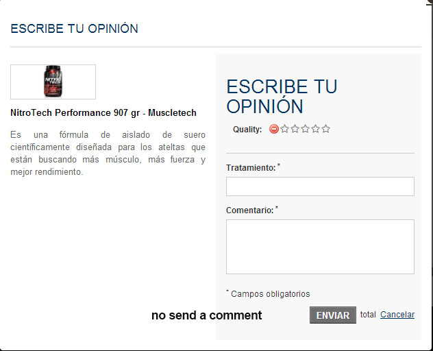

Hello,
I am facing problem with module Product Comments. When I finished comment and review I clicked on "SEND" button but nothing happened. So I checked Module Product Comments and it showes New update of this version so I updated for the latest version but after that it shows error message "Can not install". I also tried manually download Module from Prestashop website and replace by FTP there the new version but now it still can not install.
Does anybody know how to fix it?
Thank you

This is the error:
productcomments_url_rewrite is not defined
Should be defined here
{addJsDef productcomments_url_rewrite=$productcomments_url_rewriting_activated|boolval}
themes\default-bootstrap\modules\productcomments.tpl
Check that you have it in your theme as well, or in the original tpl

]in ps 1.6.0.6 not submit a comment, defines.inc error:
  • Notice: Undefined index: tabs inC:\xampp\htdocs\people_presta\cache\smarty\compile\69\e1\e8\69e1e837423c7a1f93a2cf6e29380a91dae861c6.file.product.tpl.php on line 774
    Notice: Trying to get property of non-object in C:\xampp\htdocs\people_presta\cache\smarty\compile\69\e1\e8\69e1e837423c7a1f93a2cf6e29380a91dae861c6.file.product.tpl.php on line 774
in local, but remote server not work, no send a comment
productcomment version:v3.3.5, in v3.3.4 not work
Edited by Ron morales (see edit history)
[attachment=101482:Sin título-1.jpg
cases like this one needs inspection so if it is possible please share remote url address
