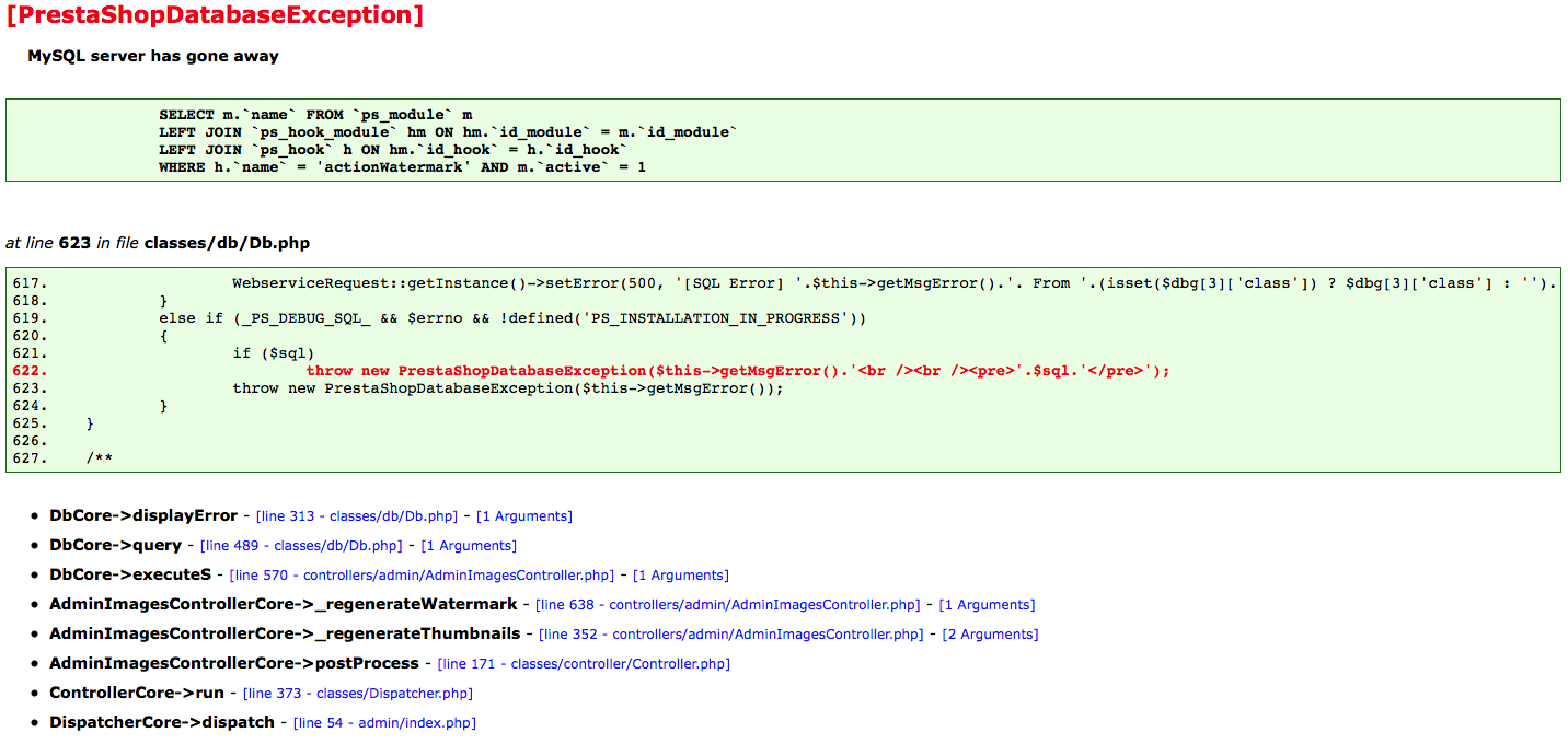

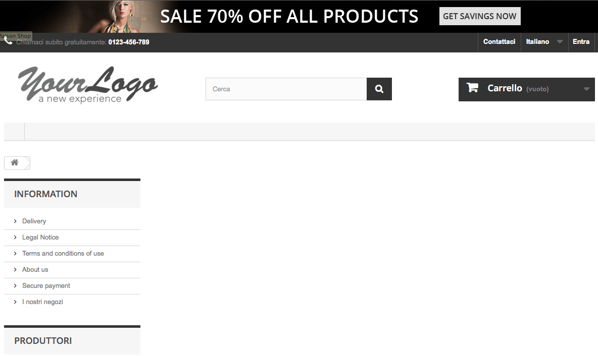

seowebmaster Posted April 11, 2014 Share Posted April 11, 2014 Hi, After importing data from my prestashop 1.4.7 to 1.6, I tried to generate thumbnails, but an exception occurs (see the attached pic). Moreover, my account pages are not shown. It is everything blank except header, sidebar and footer. PS. I am using the default template Link to comment Share on other sites More sharing options...
seowebmaster Posted April 11, 2014 Author Share Posted April 11, 2014 Anyone? I did manage to generate thumbnails, but I disabled displaying errors... ... while I couldn't make appear the authentication page (my account, login etc...). For this there is no error even if I enable error display. Which could be the reason? While does it stop loading the page? DB issues? Ajax? Link to comment Share on other sites More sharing options...
seowebmaster Posted April 11, 2014 Author Share Posted April 11, 2014 I cannot open even Advanced Parameters > Configuration Information I got a complete blank page Link to comment Share on other sites More sharing options...
vekia Posted April 12, 2014 Share Posted April 12, 2014 hello you use some module which deals with "watermark" ? Link to comment Share on other sites More sharing options...
seowebmaster Posted April 12, 2014 Author Share Posted April 12, 2014 (edited) hello you use some module which deals with "watermark" ? No, I am not using any particular module, only default ones. Actually, I saw a module called watermark and I tried to install it and everything went wrong. Now I get an error 500 and I am going to contact my hosting provider. Edited April 12, 2014 by seowebmaster (see edit history) Link to comment Share on other sites More sharing options...
vekia Posted April 13, 2014 Share Posted April 13, 2014 internal server error = turn on error reporting open config/defines.inc.php find this line define('_PS_MODE_DEV_', false); change to look like this: define('_PS_MODE_DEV_', true); with error reporting we will be able to see what's exactly going on wrong Link to comment Share on other sites More sharing options...
seowebmaster Posted April 14, 2014 Author Share Posted April 14, 2014 internal server error = turn on error reporting open config/defines.inc.php find this line define('_PS_MODE_DEV_', false); change to look like this: define('_PS_MODE_DEV_', true); with error reporting we will be able to see what's exactly going on wrong I've already done that, but I obtain the same result: internal server error! Really do not know what is happening... Link to comment Share on other sites More sharing options...
seowebmaster Posted April 14, 2014 Author Share Posted April 14, 2014 (edited) I managed to access to error files in the server and I have the following errors: 1. PHP Fatal error: Call to undefined method Tools::isPHPCLI() in ~/public_html/config/config.inc.php on line 64 AND 2. ~/public_html/.htaccess: Options not allowed here I think error 500 is caused by the second one... Edit: In .htaccess file I have # ~~end~~ Do not remove this comment, Prestashop will keep automatically the code outside this comment when .htaccess will be generated again # start ~ module watermark section Options +FollowSymLinks RewriteEngine On RewriteRule [0-9/]+/[0-9]+\.jpg$ - [F] # end ~ module watermark section If I comment this I obtain: Fatal error: Call to undefined method Tools::isPHPCLI() in ~/public_html/config/config.inc.php on line 64 Any suggestion Edited April 14, 2014 by seowebmaster (see edit history) Link to comment Share on other sites More sharing options...
seowebmaster Posted April 14, 2014 Author Share Posted April 14, 2014 (edited) I was overriding Tools.php file and I just removed it and commented the part of FollowSymLinks in .htaccess file. Now back to the original problem: - Cannot see the user authentication part of my website (sidebar, header and footer are there) - Cannot open Advanced Parameters > Configuration Information (complete blank page). Obtain Fatal error: Maximum execution time of 30 seconds exceeded in ~/public_html/classes/ConfigurationTest.php on line 193 Suggestions? Edited April 14, 2014 by seowebmaster (see edit history) Link to comment Share on other sites More sharing options...
