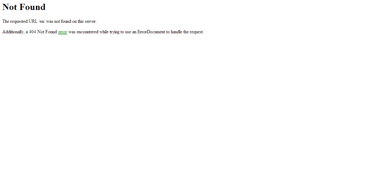

jodysingh786 Posted April 9, 2014 Share Posted April 9, 2014 (edited) I have changed my hosting and just uploaded my site to the new cpanel. But it gives an error 404 ie,. the url shows '/en/' added to it. how toio correct this pklz. My website url is www.buypharmacydrug.com Edited April 9, 2014 by jodysingh786 (see edit history) Link to comment Share on other sites More sharing options...

jodysingh786 Posted April 10, 2014 Author Share Posted April 10, 2014 (edited) I just did it. They were already on 755 though. but now what? The screen I see is attached here too. Edited April 10, 2014 by jodysingh786 (see edit history) Link to comment Share on other sites More sharing options...

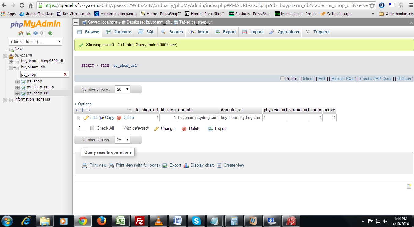

walidon Posted April 10, 2014 Share Posted April 10, 2014 according to the error, the url of your website is not correct! there is a mistake, can you go to your DB and in the table ps_shop_url and check there! Link to comment Share on other sites More sharing options...
jodysingh786 Posted April 10, 2014 Author Share Posted April 10, 2014 (edited) please find the screenshot of my ps_shop_url table. The url is buypharmacydrug.com and it is correct in the table too but its still not showing. Edited April 10, 2014 by jodysingh786 (see edit history) Link to comment Share on other sites More sharing options...
