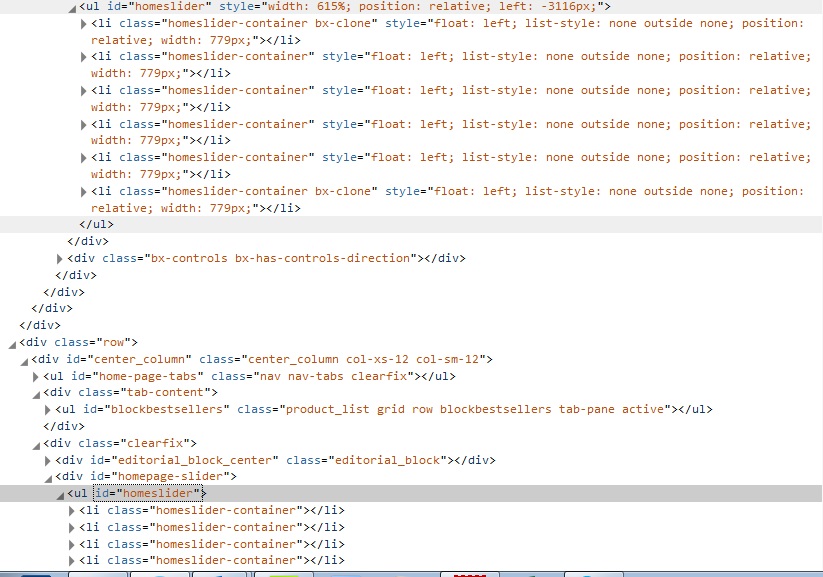

Ray UK Posted April 10, 2014 Share Posted April 10, 2014 (edited) I gave it another go upgrading... Now 1.3.4 is out and im getting this error [PrestaShop] Fatal error in module install-1.3.2: syntax error, unexpected 'recurseCopy' (T_STRING), expecting '(' I have tried re-uploading the unmodified module, it works, but I cant configure because there is an update So im forced to update, and the module bring up an error. 1.6 has been nothing but a pain in the butt since release Looks like its here that is causing the problem ? ( in install-1.3.2.php ) if (!function_exists('recurseCopy')) function recurseCopy($src, $dst, $del = false) { $dir = opendir($src); Edited April 10, 2014 by MerseyRay (see edit history) Link to comment Share on other sites More sharing options...
xhostar Posted April 10, 2014 Share Posted April 10, 2014 (edited) Edit file: /modules/homeslider/upgrade/install-1.3.2.php solution: if (!function_exists('recurseCopy')) : <- colon blah blah blah endif; <- at the end of the file honestly, they should be careful programming, gives bad image such errors... Edited April 10, 2014 by xhostar (see edit history) 1 Link to comment Share on other sites More sharing options...
Ray UK Posted April 10, 2014 Share Posted April 10, 2014 (edited) cheers xhostar, I originally deleted the whole 'if' line and that worked. Ive now replaced it and added the colon Didnt need the endif; though, when I added that it highlighted as an error. So, the module is now updated and working, complete with the bug regarding the width ( I specify 1107 in module width, but it stays as 779px width, So I have to start editing the js file again) But, now I have 2 sliders on my homepage 1 slider is at the top where it should be, and is working... but not the right width 2nd slider is at the bottom, and is just a list of the images I dont think this 1.6 is ready for live shops yet, its just problem after problem Edited April 10, 2014 by MerseyRay (see edit history) Link to comment Share on other sites More sharing options...
