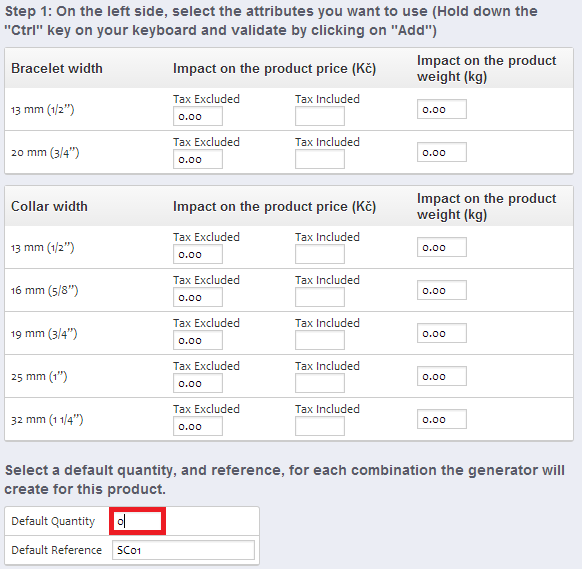

janfrilich Posted April 6, 2014 Share Posted April 6, 2014 Hello, we have a problem with product combinations generator and I would really appreciate your help. In case we set product quantity to "0" (please see screenshot) and generate the combinations, the following issues occur in FO: - it is not possible to select combination - it is not possible to change currency - it is not possilbe to change language - it is not possible to enlarge the image If I check the console, there is following js error: Uncaught TypeError: Cannot read property 'length' of undefined (product.js:238) updateDisplay (product.js:238) findCombination (product.js:132) onchange We use PS 1.5.6.1 & 1.5.6.2 and error occurs also in default theme. Thank you in advance. Link to comment Share on other sites More sharing options...
El Patron Posted April 6, 2014 Share Posted April 6, 2014 What you set to '0' is the 'default' quantity, which should be set at min. '1'. This is not the stock quantity. I hope that helps you. Link to comment Share on other sites More sharing options...

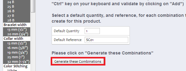

janfrilich Posted April 7, 2014 Author Share Posted April 7, 2014 Thank you for your reply. I set default quantity to '1', generate combinations and everything works until I tried to purchase this product. After purchasing of this product the issue occurs again..! Do you have any idea what could be wrong? Please see my settings: Link to comment Share on other sites More sharing options...

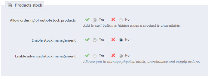

El Patron Posted April 7, 2014 Share Posted April 7, 2014 Thank you for your reply. I set default quantity to '1', generate combinations and everything works until I tried to purchase this product. After purchasing of this product the issue occurs again..! Do you have any idea what could be wrong? Please see my settings: img.png so, we solved the issue of not being able to generate combinations by setting default quantity to 1, yes? When you say error occurs again, are you saying the error in generating combinations happens again? in your screen shot, can you turn on 'stock management', I assume are will be using stock management. Link to comment Share on other sites More sharing options...
janfrilich Posted April 7, 2014 Author Share Posted April 7, 2014 (edited) Please find answers below in red so, we solved the issue of not being able to generate combinations by setting default quantity to 1, yes? When you say error occurs again, are you saying the error in generating combinations happens again? There were no problems with generating of combinations...We were always been able to generate combinations, but when it was default quantity set to '0', the issues mentioned above occured. In case we set default quantity to '1' everything in FO worked well until we purchased this product. in your screen shot, can you turn on 'stock management', I assume are will be using stock management. We are planning to not use stock management. However, when I turn on stock management, the issues occur when the product quantity decrease to '0' again.. I have sent you admin details via PM. Edited April 7, 2014 by janfrilich (see edit history) Link to comment Share on other sites More sharing options...
El Patron Posted April 7, 2014 Share Posted April 7, 2014 We are planning to not use stock management. However, when I turn on stock management, the issues occur when the product quantity decrease to '0' again.. thanks for quick reply, but I am unsure of issue occurs again. Can you explain what the exact issue is if it's not original error off generating combination? thanks, sorry I'm a little slow this morning. Link to comment Share on other sites More sharing options...
janfrilich Posted April 7, 2014 Author Share Posted April 7, 2014 (edited) Ok, let me describe it step by step - lets assume that stock management is turned on. 1. I generate combinations for product, default quanity is set for example to '1' (when product quantity is set to '0', issue occurs immediately) 2. Everything in FO work well.. 3. I purchase the product (quantity decreases to 0) and following issues occur: - it is not possible to change product combination (price) - it is not possible to change language & currency - AJAX cart is not working - it is not possible to enlarge product image Hope it helps for better understanding.. I really appreciate your assisstance. Thank you. Jan Edited April 7, 2014 by janfrilich (see edit history) Link to comment Share on other sites More sharing options...
