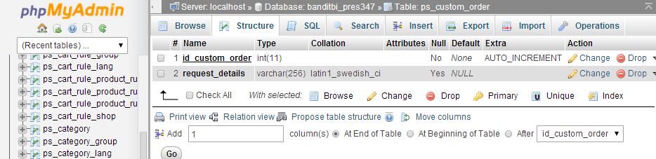

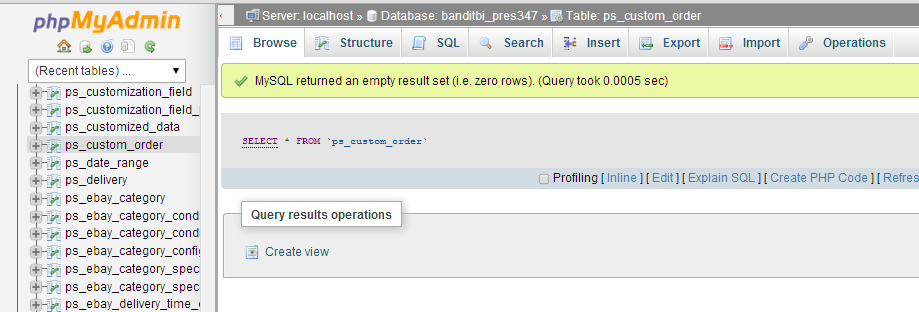

banditbirds Posted April 4, 2014 Author Share Posted April 4, 2014 hi, database creation. The module installs fine. And the table ps_custom_order is created ok in my database. But there are no columns/fields = id_custom_order, request_details (pic attached). Maybe these only appear when I input data in the fields?? Link to comment Share on other sites More sharing options...
banditbirds Posted April 4, 2014 Author Share Posted April 4, 2014 I dropped the table in phpMyAdmin and re-installed the module. It has created the table with both fields now (pic attached) Link to comment Share on other sites More sharing options...
