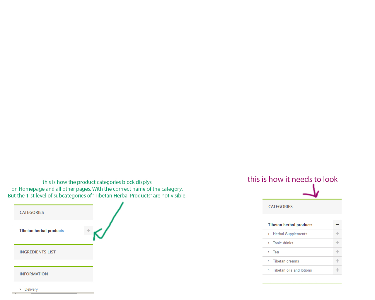

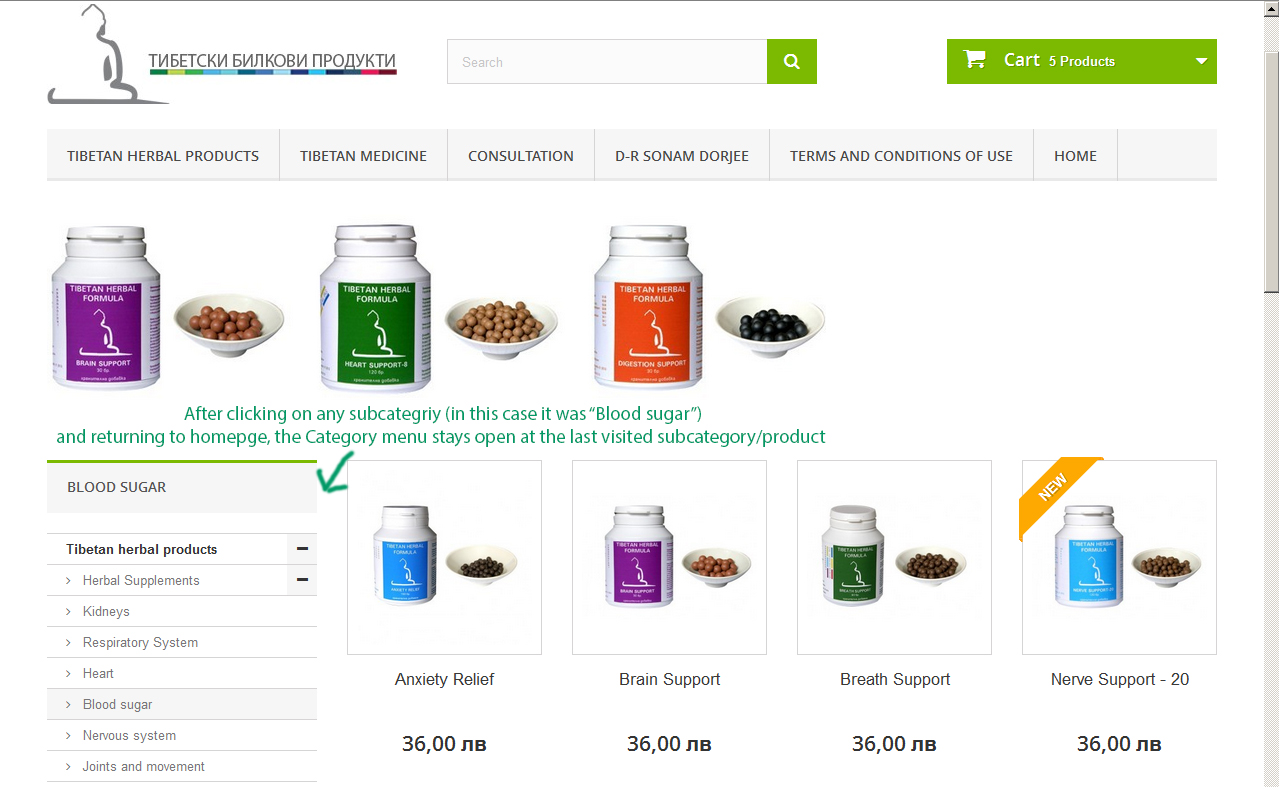

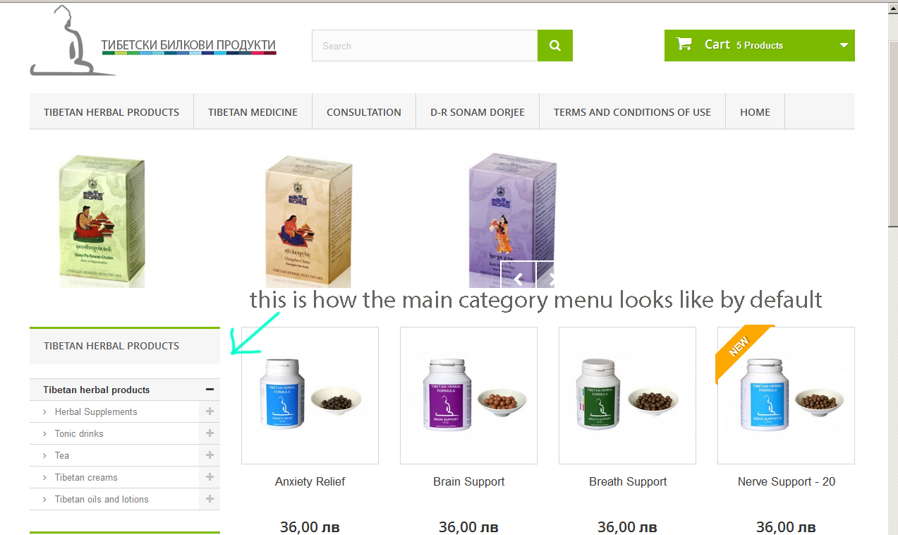

gloginko Posted April 1, 2014 Share Posted April 1, 2014 (edited) Hi, I'm encountering the following big problem: After a product or a subcategory of the main Categories menu is clicked and then i return to the home page - then the category menu (located on the left side of the page) stays open and displays the last visited product or subcategory. Instead of returning to its original state. For example: In its default state my Categories menu in the left side of the page looks like in the attached picture No. 1. But then on picture no.2 : it is visible that after browsing through some products or subcategories (in this case the subcategiry was "Blood Sugar") and returning to home page - the categories menu stays open on the last visited subcategory - respectively product, and did not return to it's original state (please compare pictures 1 and 2) Please advise a solution. My site is still a work in progress but is accessible on prestashop.herbalbg.com Thanks a lot Edited April 1, 2014 by gloginko (see edit history) Link to comment Share on other sites More sharing options...

gloginko Posted April 3, 2014 Author Share Posted April 3, 2014 Hi, I just got the Product ctaegory block on left side to refresh and appear with the main Category "Tibetan Herbal Products" on all pages - in BO juse positioned the block above "News block" and after refreshing now it seems to be working properly, So kindly ignore my last post. The onyl issue left to address is: is there a way to make the category block refresh and display the first set of products subcategories As when the "+" sign is clicked. In the attached picture there is comparison between the way the category block displays at the moment and the way it needs to be displayed. Thanks a lot again Link to comment Share on other sites More sharing options...
