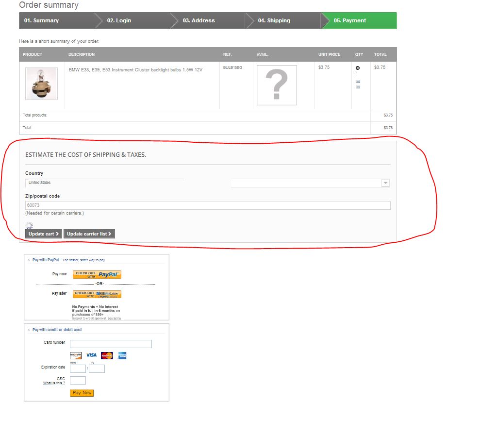

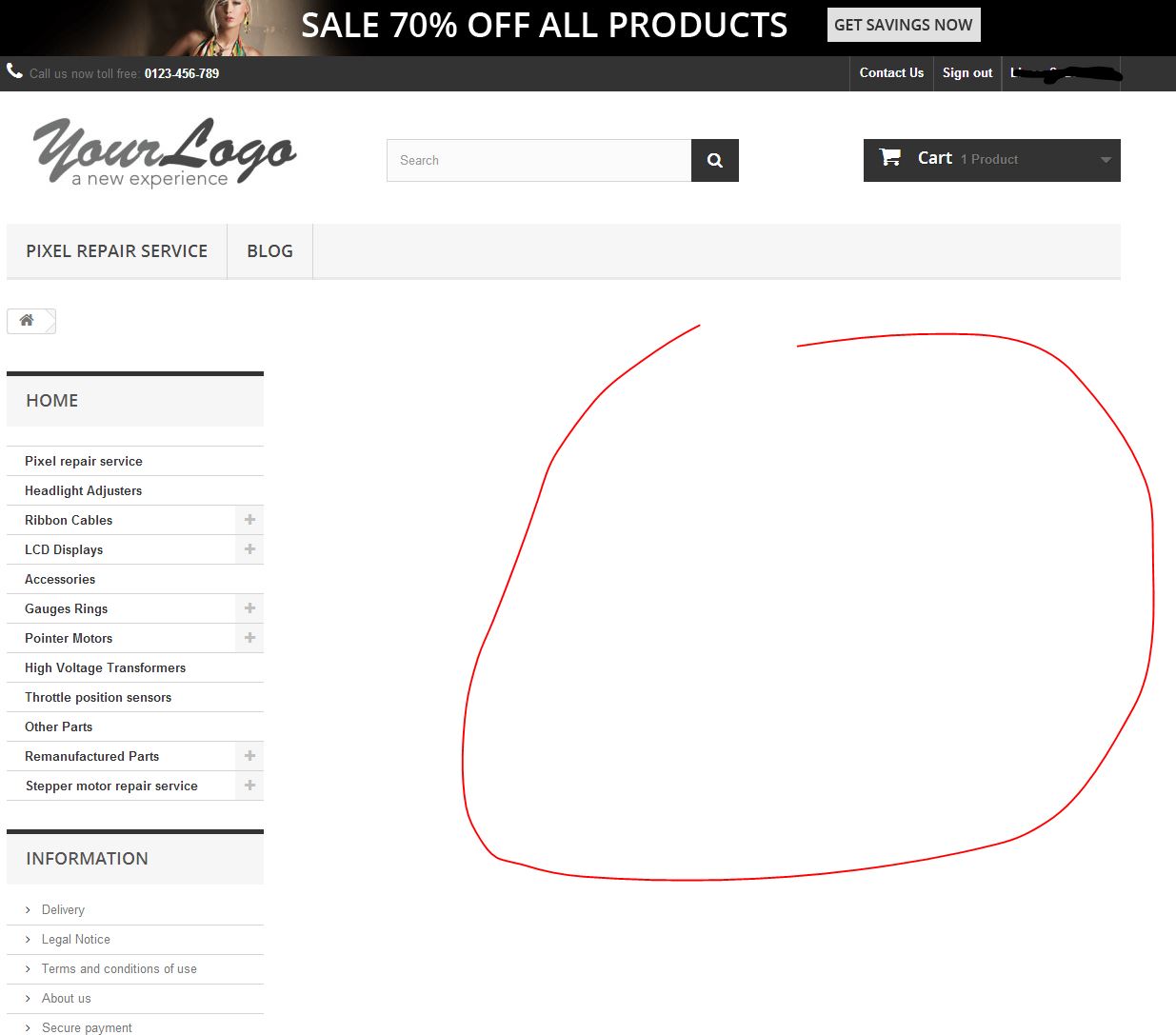

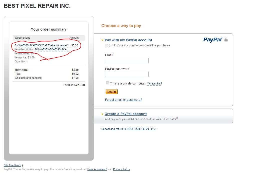

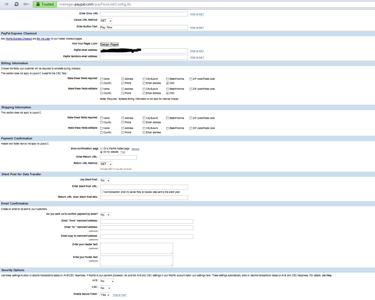

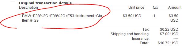

HETPE3B Posted April 1, 2014 Share Posted April 1, 2014 I just installed fresh Prestashop 1.6.0.5 coming with Paypal 1.3.3 module. I'm using Paypal Advanced part from Paypal module. When customer clicks on the payment button, it takes him to Paypal website where he completes the checkout and after that it redirects him back to my webstore blank page (there is a header and left column existing, but main area is blank) and the item is still sitting in the cart. I do not have famous 500 or 404 error. I made sure that Paypal module have 755 and 644 permissions for folders and files accordingly. I also was enabling debug mode in the config directory, but no errors did popup. I assume, that the problem is on Paypal Manager settings side. If anybody have this module working fine in Paypal Advanced mode - please show your screenshot of your settings (of course I do not need your sensitive information ) It also looks a little strange how checkout looks on Paypal website (and in the email from Paypal as well). There are "+" signs between the words. I was trying to turn on Paypal Standard from the same module (1.3.3) - and it works fine. It generates the orders fine in the BO. The problem is only with the advanced section. Link to comment Share on other sites More sharing options...
HETPE3B Posted April 1, 2014 Author Share Posted April 1, 2014 While I waiting for somebody to reply - I did try to use Modulebazaar Paypal Advanced module. The payment is coming through and order is being created however this module has it's own glitches: 1) Availability is not working properly 2) Shipping estimator for some reason is shown and of course is not working properly. Two above mentioned glitches however doesn't affect the payment and order creation process. But I still prefer to get back to live native Paypal module 1.3.3. Link to comment Share on other sites More sharing options...
HETPE3B Posted April 1, 2014 Author Share Posted April 1, 2014 I just took a look on the validation.php file in Paypalusa module.It is said there that "Step 2: You also have to sign up for PayPal Payments Advanced and a gateway (either PayFlow Link or PayFlow Pro)" What I did was I just signed up for PP Payments Advanced. Is PayFlow something different to sign up for? Like I told in my previous messages module from ModuleBazaar is processing payments normally (almost). Link to comment Share on other sites More sharing options...
HETPE3B Posted April 1, 2014 Author Share Posted April 1, 2014 During the talk with PP support they assured, that PayFlow has been added automatically with signing up to PP Payments Advanced. Don't know where to dig from here now. Link to comment Share on other sites More sharing options...
