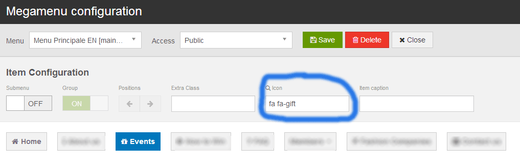

vekia Posted April 7, 2014 Share Posted April 7, 2014 an you show the code? and also where exactly you want to display icon? everything depends on it! Link to comment Share on other sites More sharing options...
alfredopacino Posted April 7, 2014 Author Share Posted April 7, 2014 i want to do that Link to comment Share on other sites More sharing options...

alfredopacino Posted April 27, 2014 Author Share Posted April 27, 2014 (edited) okay but what is your code that you used? and where you used it? how? can you show it? blocktopmenu.php row 540th doesn't work even like that, no conditions, i added just the icon $this->_menu .= '<li '.$selected.'> <i class="fa fa-envelope-o"></i>'; $this->_menu .= '<a href="'.$links[0]['link'].'">'.$cms->meta_title.'</a>'; $this->_menu .= '</li>'; Edited April 27, 2014 by alfredopacino (see edit history) Link to comment Share on other sites More sharing options...
