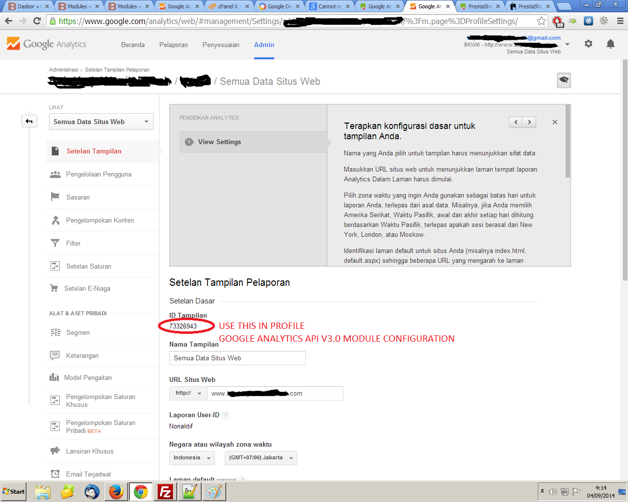

You can find your profile ID in the address bar of your browser while accessing Analytics report.
For the OLD VERSION analytics page the ID=xxxxxxxx is the following:
https://www.google.com/analytics/reporting/?reset=1&id=XXXXXXXX&pdr=20110702-20110801
For the NEW VERSION analytic page it is the number at the end of the URL starting with p:
https://www.google.com/analytics/web/#home/a11345062w43527078pXXXXXXXX/

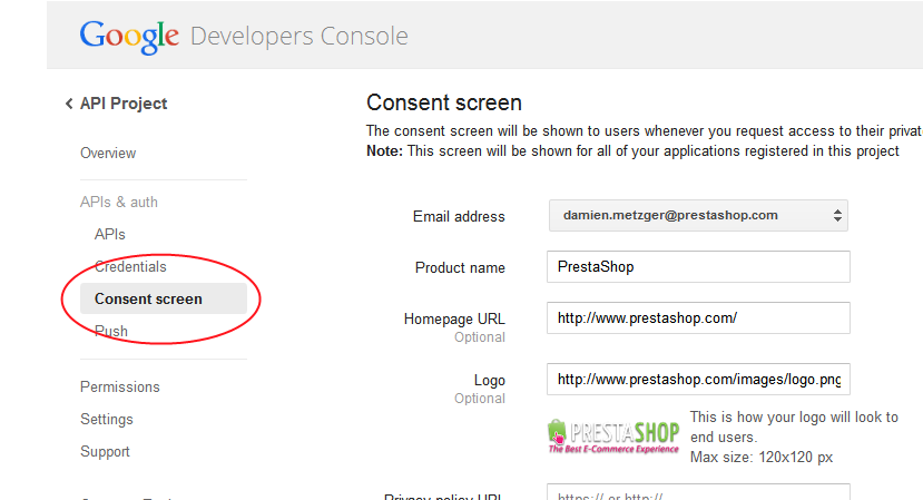

I had the same issue. I resolved it (for my issue):
-  on G analytics, click on content screen on the left menu
- fill correctly the form
- wait 2 minutes and restart to save your parameters on your prestashop configuration clicking on save button
enjoy

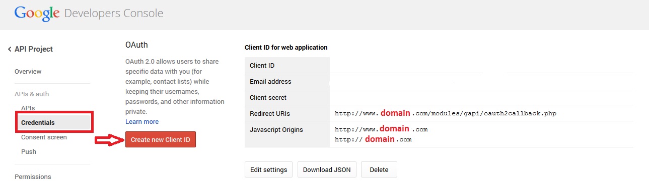

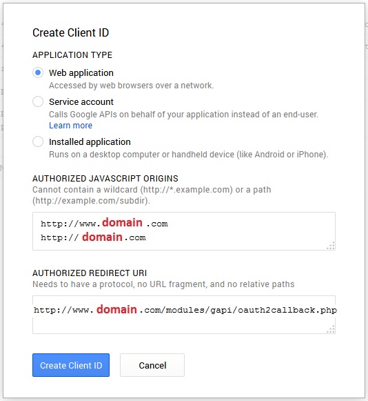

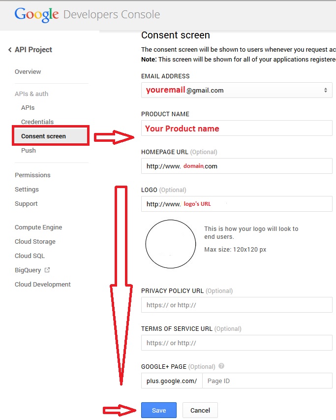

Hi,
I had the same issue and I've solved in the following way:
1) I've created a new api project.
2) Go to APIs&auth-> Credentials and click on Create new client id (See img).
3) Application Type: Web Application and add the shop url with and without 'www' (See img) and save all.
4) Go to Consent Screen and insert your data (see img) and save.
At this point go on your BO, insert your Client ID, Client Secret and profile number, save and done.
Sorry for my english :P

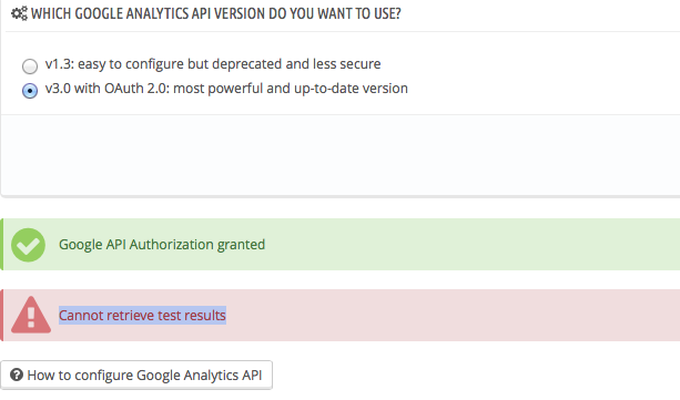

I have tried and I have the following message:
Google API Authorization granted
Cannot retrieve test results
Do you have the same?

Hi,

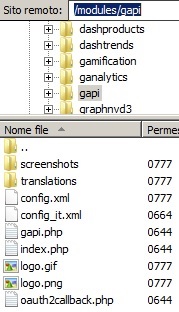

heap all as it should be but don't seem to have the config - it file as suggested??? very strange
Hi #cv :D
In this case is better turn off the pc and go out!!! :D
So, try it:
1) Disable gapi's module and delete it.
2) With your ftp agent, delete the gapi's folder
3) Reinstall the module and reconfigure it.

Hi,

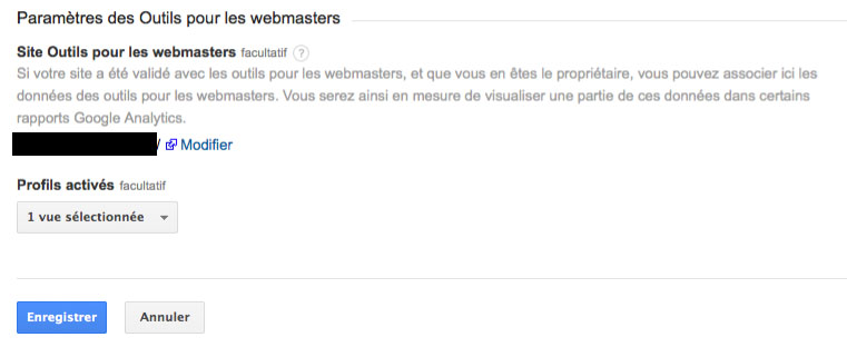

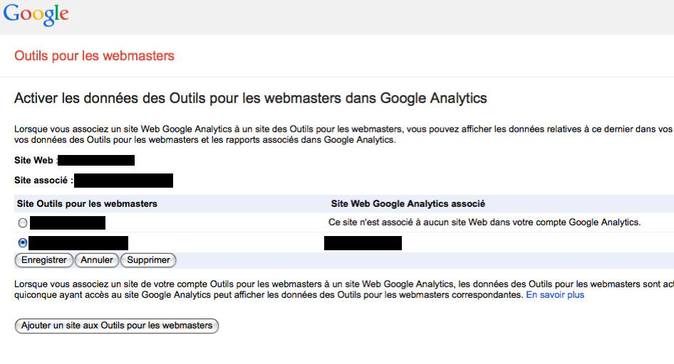

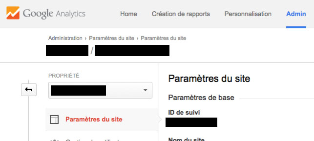

Après avoir tourné-viré et beaucoup lu, j'ai la réponse qui va vous plaire, enfin !
Petit rappel des faits :
Sur le site Google Analytics :
rubrique "admin"
Tout en bas, dans "Paramètres des outils pour les webmasters"
J'ai associé l'URL de mon site internet à ma boutique
Et enfin,
j'ai laissé le champs libre pour "Profile" dans le module de Prestashop
Et ça marche !
J'espère faire des heureux...

I have double and triple checked everything.  No matter what I do I still have
What could I have scoured this thread and others, I have both the google analytics api module configured as well as the ganalytics module configured, yet I'm still getting the same issue.
Doublechecked permissions, config settings on both modules, google analytics config settings and still the issue persists.  I'm so shocked that using these two modules seems to be the recommended means to link google analytics to a prestashop site, yet so many people seem to be having the same issues with it.
What can we do to overcome/resolve this issue?  Any guidance/direction/resolution would be greatly appreciated.  Thanks in advance.
(I have a property consent setup, id, profile etc.. )

Maybe you can try my solution, it's work with My Shop PS 1.6.0.9 and GOOGLE ANALYTICS API V3.0
In My Google Analytics Api Configuration
ID Client : MyIdClient.apps.googleusercontent.com
Client Secret : MyClientSecret
Profile : XXXXXXXX --> 8 Digits in Google Analytics --> Admin --> Views Setting
Screenshots:
Screenshots:
IronBackbone the profile ID you found is the same you can see in Analytics URL, as specified in the guide.
so the result is the same, Cannot retrieve test results
