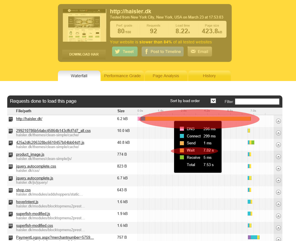

mpeg69 Posted March 23, 2014 Share Posted March 23, 2014 Hi all, I am STILL struggling with my performance problem on www.haisler.dk ... there is an extremely long waiting time before my first page appears... (See attachment) The test is done using this tool: http://tools.pingdom.com/fpt/#!/cJWeMp/http://haisler.dk My PrestaShop developer has not been able to identify the problem, and says that the PrestaShop is working as it should.. he is pointing at the server. My site is hosted at meebox and they say that the server is running as it should ?? .. i do not know how to proceed from here, and hope someone can help me... or perhaps point me to some tools that can be more specific about the waiting time. I really need to get rid of this waiting time. Thank you very much !! /Morten Link to comment Share on other sites More sharing options...

mpeg69 Posted March 30, 2014 Author Share Posted March 30, 2014 (edited) Hi Again... I am a bit closer now.. it is a "common" situation: "Time to first byte" on the second request to the site. But i still have no clue how to carry on from here. The request: Request 2: http://haisler.dk/ URL: http://haisler.dk/Host: haisler.dkIP: 77.66.80.41Location: DenmarkError/Status Code: 200Client Port: 64177Start Offset: 0.884 sInitial Connection: 124 msTime to First Byte: 4929 ms <--------------------------- THIS is the problem !!!Content Download: 12 msBytes In (downloaded): 7.3 KBBytes Out (uploaded): 0.3 KB Request Headers: GET / HTTP/1.1Accept: text/html, application/xhtml+xml, */*Accept-Language: en-USX-Download-Initiator: html="doc E350 win 15B8; html document"User-Agent: Mozilla/5.0 (compatible; MSIE 9.0; Windows NT 6.1; Trident/5.0; PTST 2.376)Accept-Encoding: gzip, deflateConnection: Keep-AliveHost: haisler.dk Response Headers: HTTP/1.1 200 OKX-Powered-By: PHP/5.4.25P3P: CP="IDC DSP COR CURa ADMa OUR IND PHY ONL COM STA"Set-Cookie: 44c621219e3f66a7d4725c437c8fb0f8=hBo9U1yeHyw%3D2gGBCrqeZOo%3Dcs%2FoQW21arc%3DqpfMpjTaPKw%3D4KetwcAtPQQ%3DLkf5k3eFNhY%3DPAfdGIXn3cE%3DYww4ual1%2ByY%3D000060; expires=Sat, 29-Mar-2014 11:54:27 GMT; path=/; domain=haisler.dk; httponlySet-Cookie: ffdbd13d96d903c026c4876e97eb63a4=hBo9U1yeHyw%3D2gGBCrqeZOo%3Dcs%2FoQW21arc%3DqpfMpjTaPKw%3D4KetwcAtPQQ%3DkF%2Fq98Da5D4%3DP8r6szkYfnM%3DoXeSQ4wWer4%3DaKj7rV2R%2FYg%3Du2e9UQ%2BOq4M%3Di7yBg0ZKTDU%3DpHeT4Cz%2FOQw%3DNsJV5Zyob78%3DU7G5u%2B5h284%3DfUtXqwF9Guo%3D000115; expires=Fri, 18-Apr-2014 10:54:27 GMT; path=/; domain=haisler.dk; httponlyVary: Host,Accept-EncodingContent-Encoding: gzipContent-Type: text/html; charset=utf-8Server: - Meebox Web acceleration -X-Cacheable: YESContent-Length: [spam-filter]Accept-Ranges: bytesDate: Sat, 29 Mar 2014 10:54:31 GMTX-Varnish: 609504446Via: 1.1 varnishConnection: keep-aliveage: 0X-Cache: MISS A bit more information here: http://www.webpagetest.org/result/140329_D3_8SM/1/details/ A Little help would once Again be very much appreciated. Thanks. Kind regards Morten Edited March 30, 2014 by mpeg69 (see edit history) Link to comment Share on other sites More sharing options...

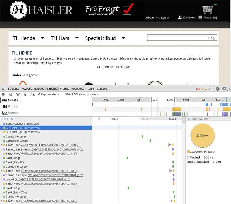

dioniz Posted March 30, 2014 Share Posted March 30, 2014 Have you tried Chrome Developers tools. In Chrome type F12 and check Timeline. If you don't see results, refresh site while tools are open. Maybe you'll get something to help you. Link to comment Share on other sites More sharing options...
Vinum Posted March 30, 2014 Share Posted March 30, 2014 Hi, Your site is relatively good optimised. Your problem is due to your first byte time which is very long. So it is necessary to change your host provider. 1 Link to comment Share on other sites More sharing options...
mpeg69 Posted March 30, 2014 Author Share Posted March 30, 2014 Have you tried Chrome Developers tools. In Chrome type F12 and check Timeline. If you don't see results, refresh site while tools are open. Maybe you'll get something to help you. Hi.. i have tried Chrome dev. tools but i get no results in timeline .. even when refreshing.. but i get this message: Invalid App Id: Must be a number or numeric string representing the application id. all.js:56 FB.getLoginStatus() called before calling FB.init(). all.js:56 Resource interpreted as Script but transferred with MIME type text/html: "https://relay.ditonlinebetalingssystem.dk/integration/PaymentLogos/PaymentLogos.aspx?merchantnumber=5759560&padding=5&cols=2". Link to comment Share on other sites More sharing options...
mpeg69 Posted March 30, 2014 Author Share Posted March 30, 2014 Hi, Your site is relatively good optimised. Your problem is due to your first byte time which is very long. So it is necessary to change your host provider. Hi, Thanks.. i have discussed this with my hosting provide, and they say there PRO-servers are fully optimized and working as they should. They host numerous PrestaShop solutions and have no problems .... Link to comment Share on other sites More sharing options...
dioniz Posted March 30, 2014 Share Posted March 30, 2014 Try to select frames and then refresh Link to comment Share on other sites More sharing options...
mpeg69 Posted March 30, 2014 Author Share Posted March 30, 2014 Try to select frames and then refresh haisler.jpg Thanks.. now it Works :-) .. but still.. it makes no sense to me :-( .. still not sure what causes the waiting time... Link to comment Share on other sites More sharing options...
Vinum Posted March 31, 2014 Share Posted March 31, 2014 Hi, You first byte time is always very bad. Your host provider will not say they are bad. You can do what you wand but a bad first byte time it is a server problem. 1 Link to comment Share on other sites More sharing options...
