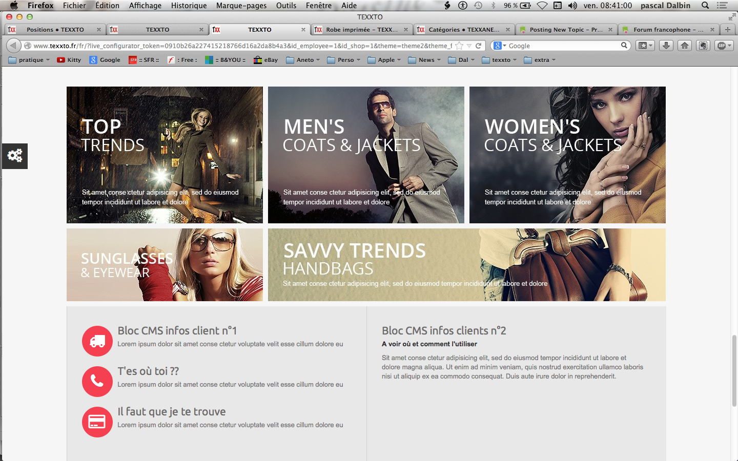

pascuald Posted March 21, 2014 Share Posted March 21, 2014 (edited) Hello , I am working on the configuration theme of 1.6 v I don't need the slider at top and i just would like 6 pictures (like the bottom part of the module) but if i take off the slider and put more pictures they don't stand side by side (3 for a line, like for the botton part of the module) but just one picture for a line. so… Anyone with a solution ??? Is it possible to simply twist the top part of the module at the bottom and vice/versa for the bottom ?? Is it possible to modify the module as it is but with the pictures stays 3 for a line ?? Thanks for the help Pascual Edited March 21, 2014 by pascuald (see edit history) Link to comment Share on other sites More sharing options...
