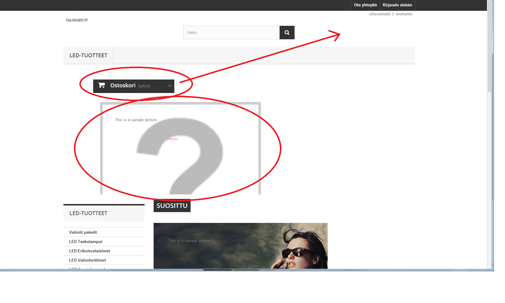

Valoilmio Posted March 18, 2014 Share Posted March 18, 2014 Very easy topic but cannot get the Live edit to move the shopping cart location -> it is just in odd placement? also picture are messed up and wrong size and also second picture comes up. Dont seem to get the same default theme to show up as in the instruction videos? updated from 1.5.6 to 1.6 without any modules installed. Link to comment Share on other sites More sharing options...

misc100 Posted March 18, 2014 Share Posted March 18, 2014 Very easy topic but cannot get the Live edit to move the shopping cart location -> it is just in odd placement? also picture are messed up and wrong size and also second picture comes up. Dont seem to get the same default theme to show up as in the instruction videos? updated from 1.5.6 to 1.6 without any modules installed. messeduptheme.png +1 Same problem. Link to comment Share on other sites More sharing options...

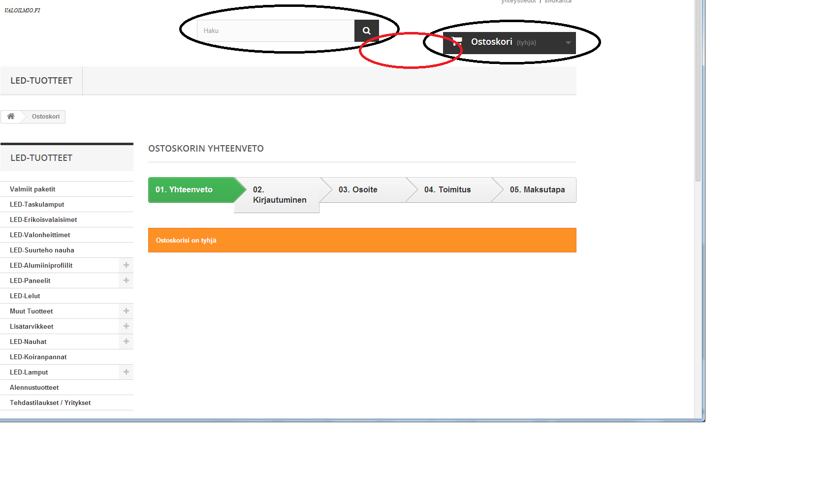

Valoilmio Posted March 19, 2014 Author Share Posted March 19, 2014 (edited) Try to reorder modules in BO > Modules > Positions Tried to reorder -> put cart as first but no effect. Found the reason. Shopping cart is located in displayHeader. AND in display top. if you reorder display top -> example after search then it will "jump" to right position Why the cart is in 2 places? what is the reason. also notised that now the search and cart are not aligned and too much "area" is used on the top of the page. i will re-test today evening to see the positioning is really ok and then close this topic if i manage to get the search and cart to same horisontal area. Edited March 19, 2014 by Valoilmio (see edit history) Link to comment Share on other sites More sharing options...

Blackielives Posted March 19, 2014 Share Posted March 19, 2014 Many thanks for the help. That has worked, though the spacing is quite wide on the page for desktop. Link to comment Share on other sites More sharing options...
selectshop.at Posted March 19, 2014 Share Posted March 19, 2014 The new theme is fully responsive, so the spacing you are seeing is only for big screens. If you minimalize your screen than the space reduces. Link to comment Share on other sites More sharing options...
