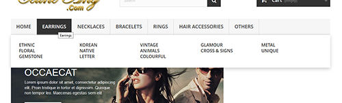

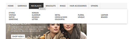

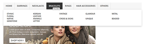

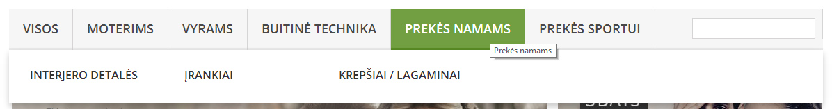

Augitec Posted March 18, 2014 Share Posted March 18, 2014 Hello friends, I'v updated my presta from 1.5 to 1.6 - now testing everything. Shop seem to work smoothly, BO & FO looks fine, but i have a problem with top horizontal menu. It should look like this But in some cases it looks like that: When i add some subcategories - they go not in one line - but it goes under one another... I'v tried to remove the category, clear cache and so on, but then the same happens in other (random) category... Is there any solution for this? Thanks Link to comment Share on other sites More sharing options...

Augitec Posted March 19, 2014 Author Share Posted March 19, 2014 I think my issue is the same as this: http://forge.prestashop.com/browse/PSCSX-1202 For now i'v simply solved it by adding additional category in the end of the list. But that's definitively a bug. Will be waiting for solution from presta developers. Link to comment Share on other sites More sharing options...

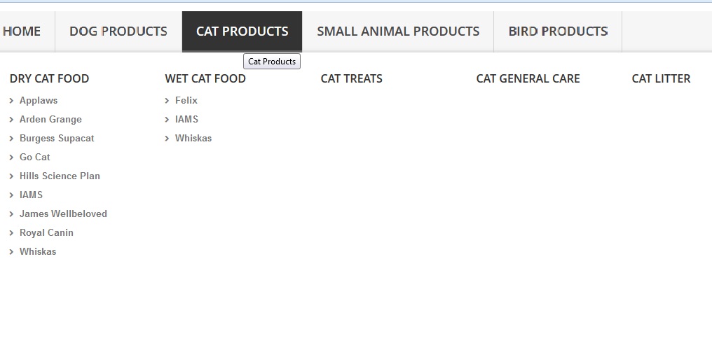

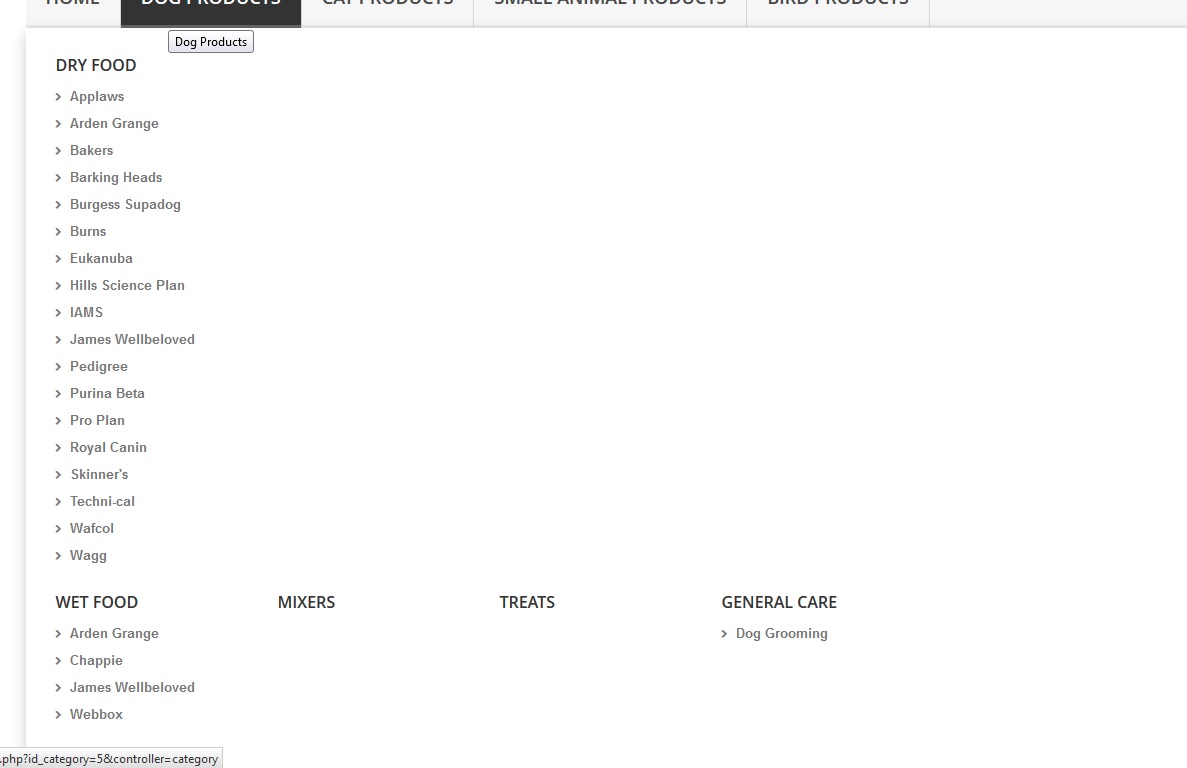

Greenpilgrim Posted March 20, 2014 Share Posted March 20, 2014 I have a similar problem with top menu where the dog products (menu1pic) menu is putting the rest of the categories below unlike the cat ones (Menu2pic). this is a clone of an old back up of my main site i made and have upgraded from 1.4.7 to the latest version. So i am haveing a play round to see if it is worth upgrading my live site url below http://www.pets.justfurpets.co.uk Cheers Chris Link to comment Share on other sites More sharing options...
vekia Posted March 20, 2014 Share Posted March 20, 2014 its because of clear:left; in: .sf-menu > li > ul > li.first-in-line-lg { clear: left; } can you disable ccc for css files, please? Link to comment Share on other sites More sharing options...
Greenpilgrim Posted March 20, 2014 Share Posted March 20, 2014 If you are referring to me i have just set Smart Cache for css and smart cache for Javascript to no. I presume this is what you mean? I am not sure if it is just the number of charachters of the sub categories making it go below the first one Cheers Chris Link to comment Share on other sites More sharing options...
vekia Posted March 21, 2014 Share Posted March 21, 2014 hello have you tried code that i suggested to use? Link to comment Share on other sites More sharing options...
rickzmond Posted March 22, 2014 Share Posted March 22, 2014 Mine is also very wrong Fresh installation http://celineang.com suppose to be like this but it turns out like this Link to comment Share on other sites More sharing options...
peanut Posted March 22, 2014 Share Posted March 22, 2014 Mine is also very wrong Fresh installation http://celineang.com suppose to be like this submenu right.jpg but it turns out like this submenu very wrong.jpg submenu wrong.jpg same here! Link to comment Share on other sites More sharing options...
prestamax Posted March 22, 2014 Share Posted March 22, 2014 (edited) its because of clear:left; in: .sf-menu > li > ul > li.first-in-line-lg { clear: left; } The clear left is there for the last sub menu item but the count is wrong for some reason. Actually the class .first-in-line-lg should be added to every fifth item of the current sub menu but the script takes all subcategories into account. And if ALL submenu items not only from the current parent category can be devided by five it adds a clear:left; $('.sf-menu > li > ul > li:not(#category-thumbnail)').each(function(){ //add classes for clearing i++; if(i%2 == 1) $(this).addClass('first-in-line-xs'); else if (i%5 == 1) $(this).addClass('first-in-line-lg'); console.log(i + " .." + $(this).text()); }); http://www.prestashop.com/forums/topic/315933-16-top-menu-sub-menu-spacing-issues/?p=1599105 Edited March 22, 2014 by prestamax (see edit history) 1 Link to comment Share on other sites More sharing options...

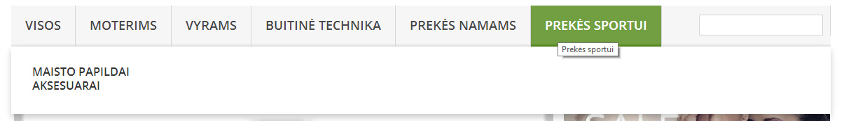

Miguel86 Posted July 9, 2014 Share Posted July 9, 2014 (edited) I have the same problem and i don't have subcategories :S I tried to apply the fix and didnt' solved my problem at least. Edited July 9, 2014 by Miguel86 (see edit history) Link to comment Share on other sites More sharing options...
