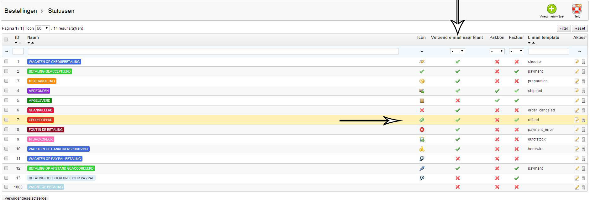

HavanA Posted March 16, 2014 Share Posted March 16, 2014 I think you can do that in (backoffice obviously): Orders - statusses, then go to the item for credit slip en disable the email message. Link to comment Share on other sites More sharing options...
ietax Posted March 16, 2014 Author Share Posted March 16, 2014 Thanks, there isn't item for credit slip in statusses... Link to comment Share on other sites More sharing options...
HavanA Posted March 16, 2014 Share Posted March 16, 2014 Search for refund, I guess that will be the correct translation (from Dutch to English). Link to comment Share on other sites More sharing options...
ietax Posted March 16, 2014 Author Share Posted March 16, 2014 Nothing... there is nothing..:! Link to comment Share on other sites More sharing options...
HavanA Posted March 16, 2014 Share Posted March 16, 2014 Doesn't your BO look like this? Link to comment Share on other sites More sharing options...
ietax Posted March 16, 2014 Author Share Posted March 16, 2014 Yes, i disabled mail but it send to customer. I think there is not a status config.. Link to comment Share on other sites More sharing options...
