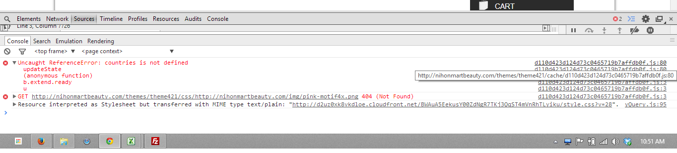

tannong Posted March 13, 2014 Share Posted March 13, 2014 Hi All Probably this issue had been reviewed many times, but i could not find the appropriate solution to my problem.. suddenly 2 days ago, i can not 1. register new email to my presta 2. after adding item to card, when people hit check out, somehow it cannot the whole process was stuck at this section nihonmartbeauty.com/authentication i tried to ctrl + shift + J in my Chrome and it says Uncaught ReferenceError: countries is not defined BUT when people login first, somehow they can complete the purchasing process. It seems that this authentication thing is blocking some how Can somebody help me shed some light Thanks Tannong Link to comment Share on other sites More sharing options...
tannong Posted March 13, 2014 Author Share Posted March 13, 2014 Its Solved Guys apparently i accidentally change the setting for minify HTML (in the BO>prefference>performace> CCC) it should be "keep HTML as original" Link to comment Share on other sites More sharing options...
