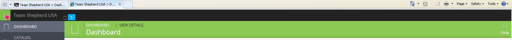

tdr170 Posted March 6, 2014 Author Share Posted March 6, 2014 That did change things the graph now works thanks. There is also issues with 1.6 and IE8 in that the pages do not seem to load correctly in the back office the header is incomplete with no way to click on View my shop, for the most part all the header info is incomplete. The icons on the FO also have issues strange though is it is a little better with the upgrade then with the clean install. This has been greatly improved over the last version but still needs some work. I realize that IE8 is getting old but there are many many people out there that are still using XP and IE8. Thanks for taking the time. Tod Link to comment Share on other sites More sharing options...
Lucas Cerdan Posted March 6, 2014 Share Posted March 6, 2014 I'm highly skeptical over the stats you're giving - that's far from the latest numbers I've been following. FYI, even Google drops supports for IE9: http://googlesystem.blogspot.fr/2013/11/google-drops-support-for-ie9.html Link to comment Share on other sites More sharing options...
tdr170 Posted March 6, 2014 Author Share Posted March 6, 2014 (edited) This was just taken from the BO stats page I have no control over the numbers, I still have XP and IE8 and yes I use chrome. But if I still have XP how many others have it, not everyone is a comp geek, example would be my sister I was at her house and had to convince her Chrome was the way to go. I understand what your saying though just trying to report the issues I see from what I have. Thanks for taking the time. Tod I looked at the link you posted interesting that IE8 is 4th on the list above IE9, Safari. Edited March 6, 2014 by tdr170 (see edit history) Link to comment Share on other sites More sharing options...
